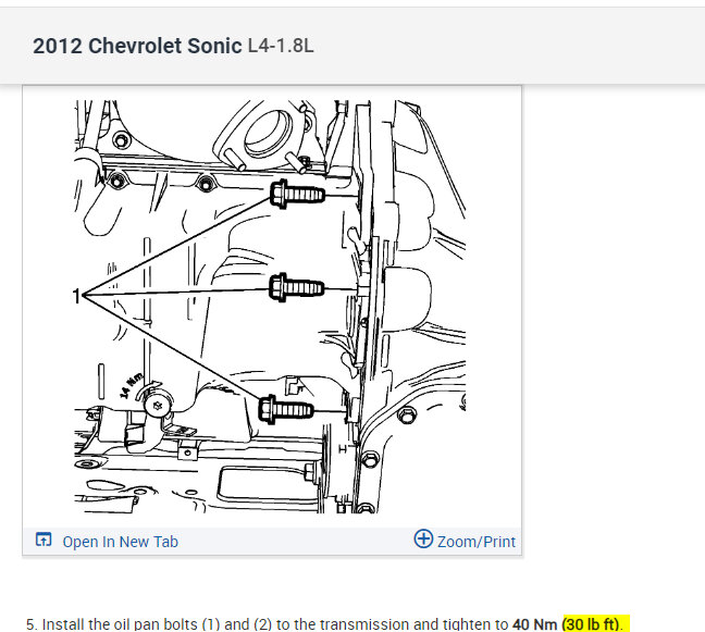

Oil pan bolts torque specs in ft lbs needed?
2012 CHEVROLET SONIC
50,000 MILES • 1.8L • 4 CYL • 2WD • AUTOMATIC
CORY2427
  • 293 POSTS
Oil pan bolts torque specs.
Aug 17, 2024 at 10:05 AM
  • 110,194 POSTS
There are two different specs for the oil pan. The ones that go to the trans are 30 t/lb.

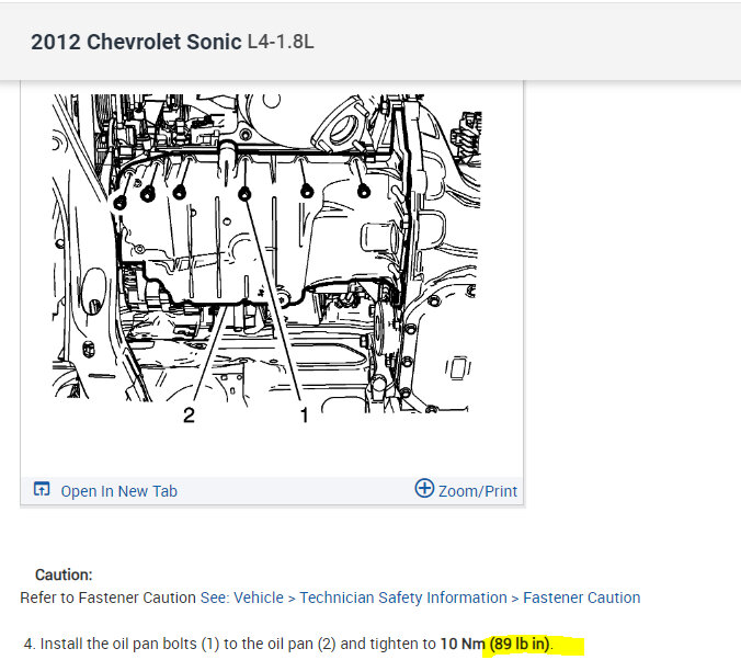

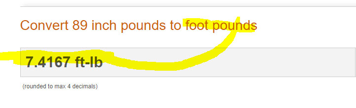

The ones along the bottom of the pan are 89-inch pounds which works out to 7.5 ft/lb. See attached below.
