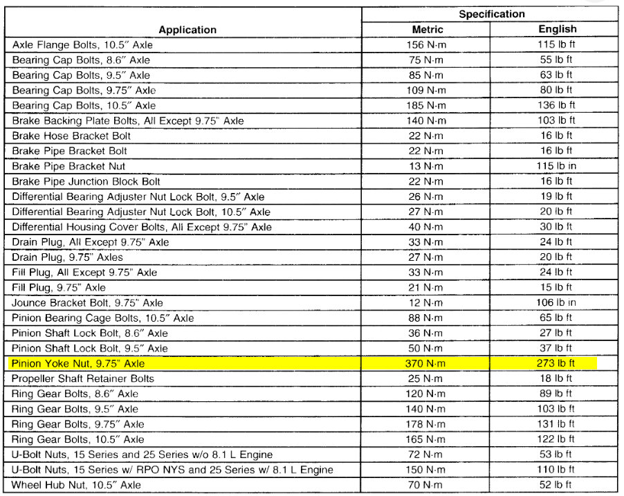

Looking for the torque specs for the yoke on the rear differential for the nut that holds pinion yoke on.

Please see attached. Let me know if you need more information. Check out the diagrams (Below). Please let us know if you need anything else to get the problem fixed. Thanks
