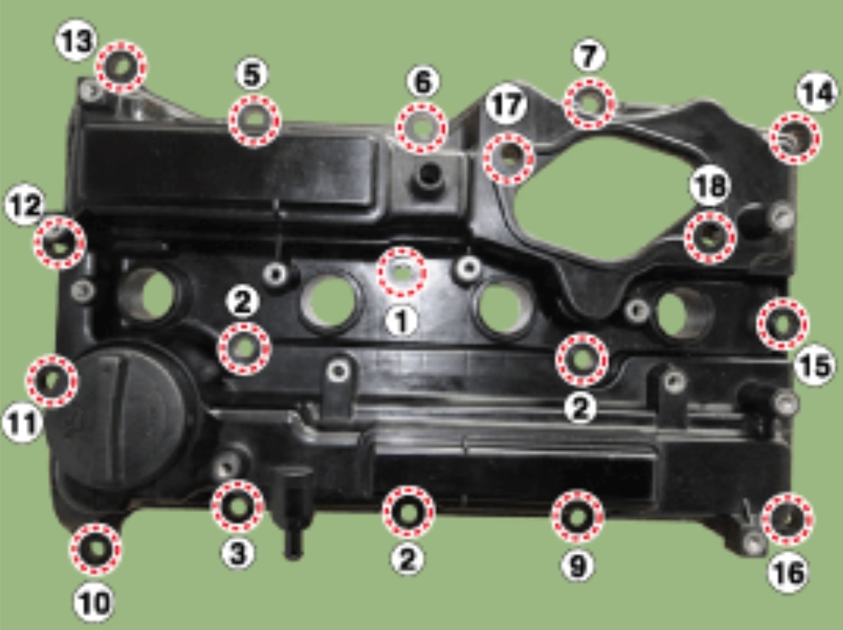

Torque specs for valve cover gasket replacement needed and the order to adjust the bolts.

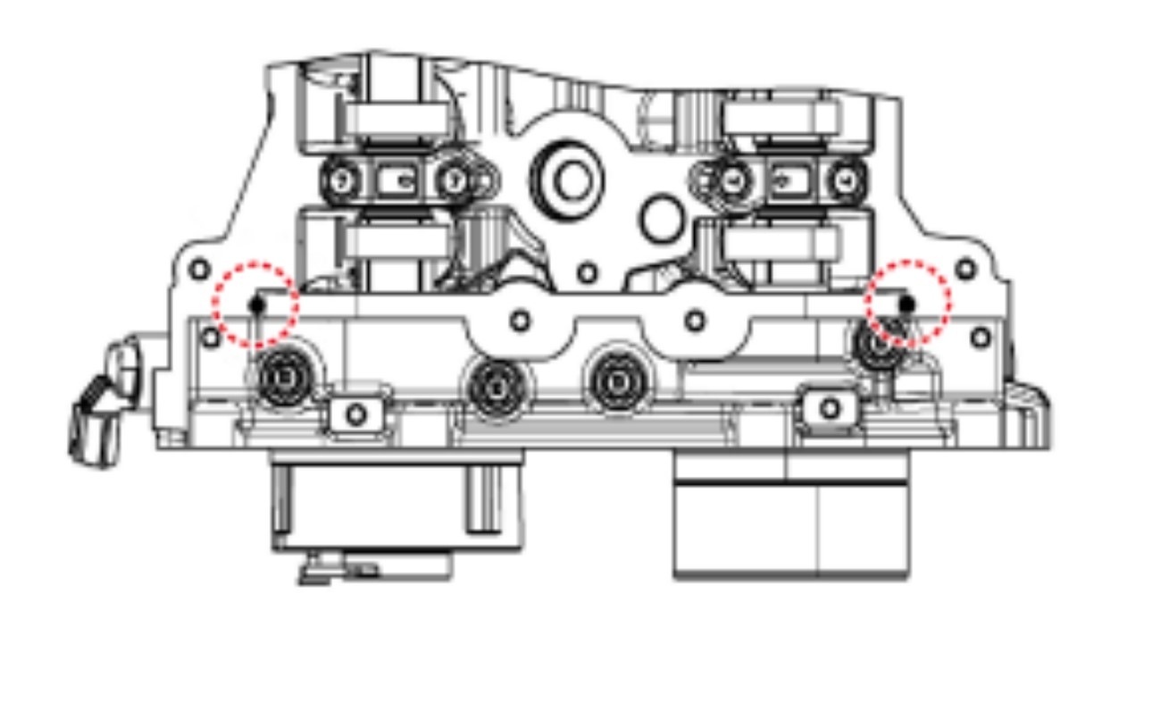

The specs are in two steps. First pass is to 3 to 5 lb ft. for each bolt.
The second pass is to go to 7 lb.ft. following the same pattern.
Don't forget the small bead of sealer at the ends of the head as shown 2.5 mm and let it set no more than 5 minutes.

9.8 NM is good i bit on the tight side but good
Dec 29, 2024 at 6:45 AM (Merged)
MECHTRIX
  • 594 POSTS
9.8 nm Or about 7.25 ft p. 10 nm is 7.37 ft p that's what I do them at ..never had any issues.. good luck
