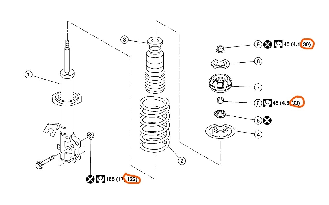

Hello, I need to replace the front struts on my vehicle listed above. I was hoping you could share the torque specs for the top and bottom mounting bolts. Thank you so much for your help.

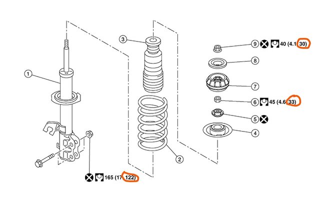

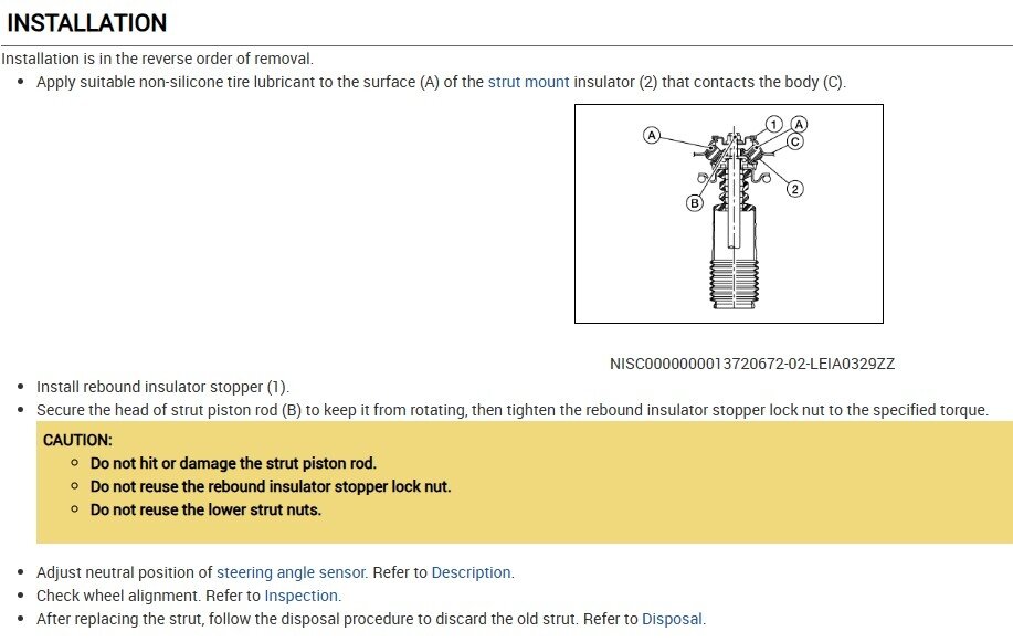

These should be correct for that vehicle. The red circled numbers are the lb ft. The first number is newton meters. The second image are the OE instructions for replacement.
If you are replacing them with stock units, you would likely be better off using loaded parts. Less money and aggravation.
This is a similar suspension; the same basic process will be used.

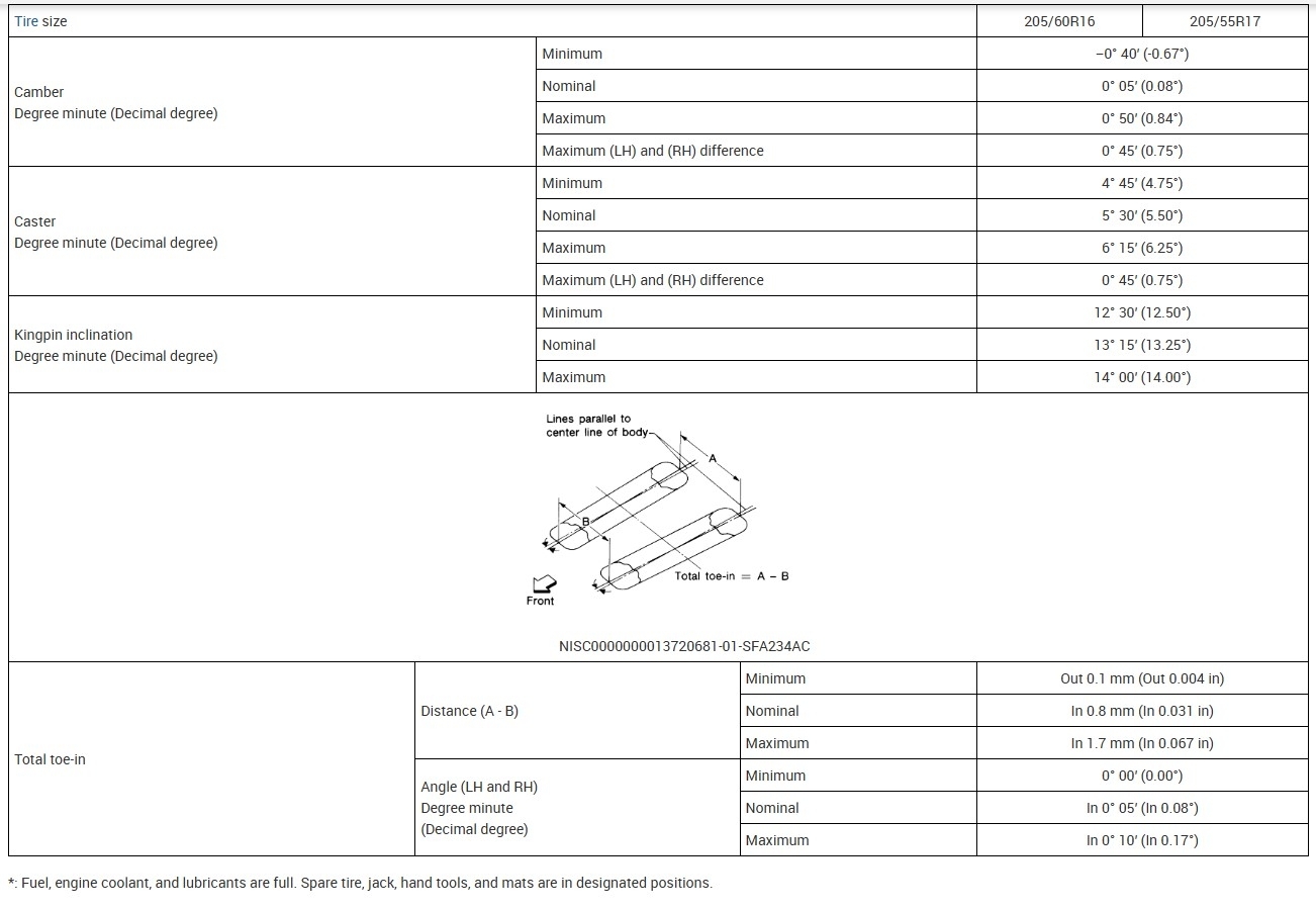

Once complete you will need an alignment. On your vehicle that is pretty much only a toe adjustment in the front. If the camber or caster is out, you would need to add a kit for each side to adjust camber and possibly alter the upper mount for caster.

Awesome, thank you so much. The only shop manual I had was for the 2024 Nissan Kicks. Glad I asked you though. Looks like the 2018 uses a little less torque.
