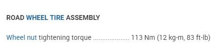

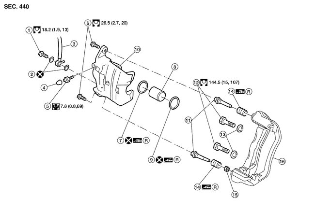

I am just asking for the torque spec for the brake caliber and holders as well as for the tire lugs. All the torque specifications for everything in the wheel house. I am changing my own brakes so I just want to be sure that I am torquing it right. Thank you

See the attached pictures for torque specs. Let me know if you have questions or need additional information.
Let me know if this helps.
