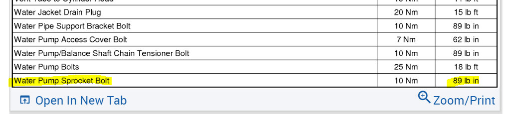

Torque specs for sprocket on timing chain water pump needed?
2009 SATURN AURA
100,000 MILES • 2.4L • 4 CYL • 4WD • AUTOMATIC
GITEKLU
Need specs.
Nov 18, 2022 at 12:53 PM
  • 110,194 POSTS
Are you referring to the water pump sprocket? If so, see the pic below. The pic is specific to your vehicle, and I included all the torque specifications related to the water pump.
See pic below.

GITEKLU
Excellent response time. Got it!!
