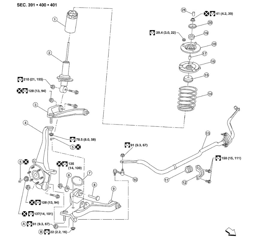

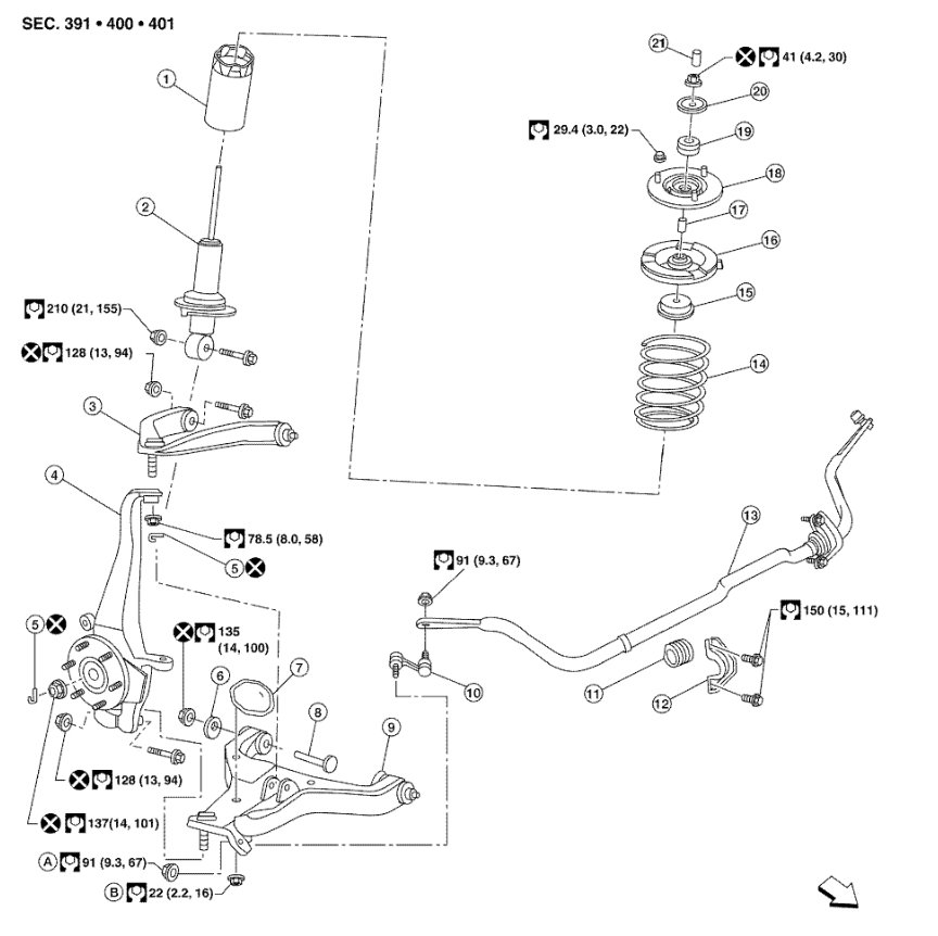

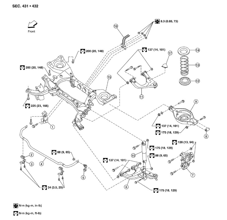

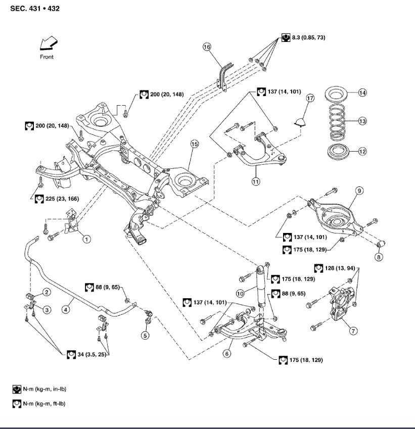

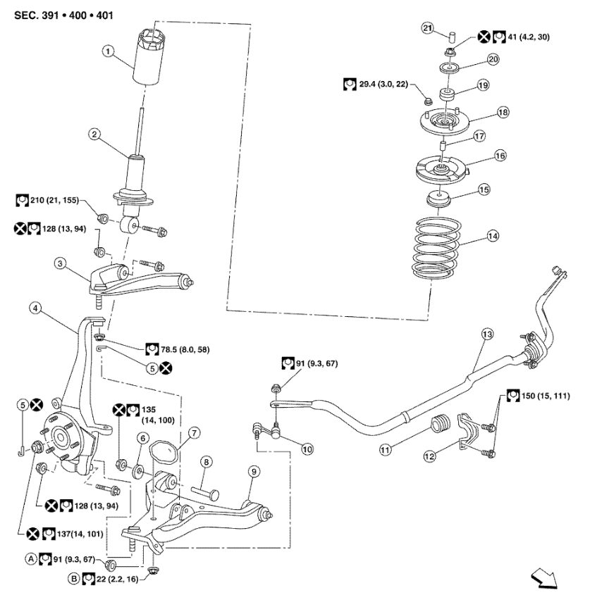

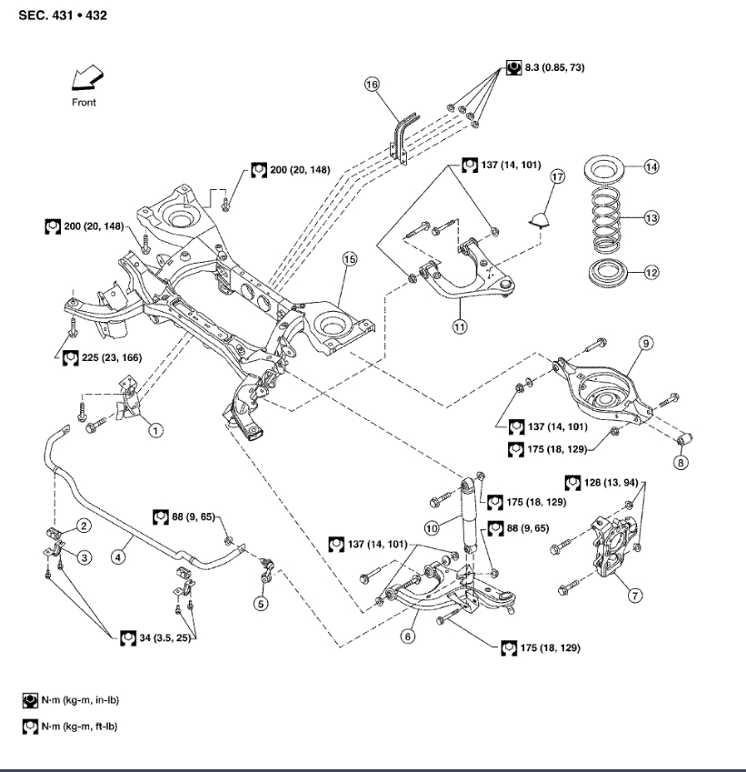

Just installed rear shocks and ordered upper and lower control arms due to rusted out old ones (had holes 4 - 6 inches long on lowers and at the shock mounts). Looking for a diagram or list of all torque specs. Will also be changing both stabilizer bar end links. Will be tackling the front as soon as I'm done with the rear, so a diagram or list of the font torque specs would be much welcomed.
Thanks so much, Bob

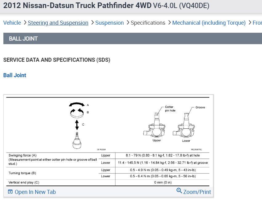

Hi Bob,
Here is the torque spec for the front and rear suspension parts you have requested. Check out the diagrams (below). Please let us know if you need anything else to get the problem fixed.
Aug 20, 2022 at 8:57 AM
SQM
  • 6,383 POSTS
See attached for both front and rear suspension diagrams with all the torque specifications.
Let me know if you need any other information.
Aug 20, 2022 at 8:58 AM

Thank you both. That is what i wanted. Kudos to you both.
