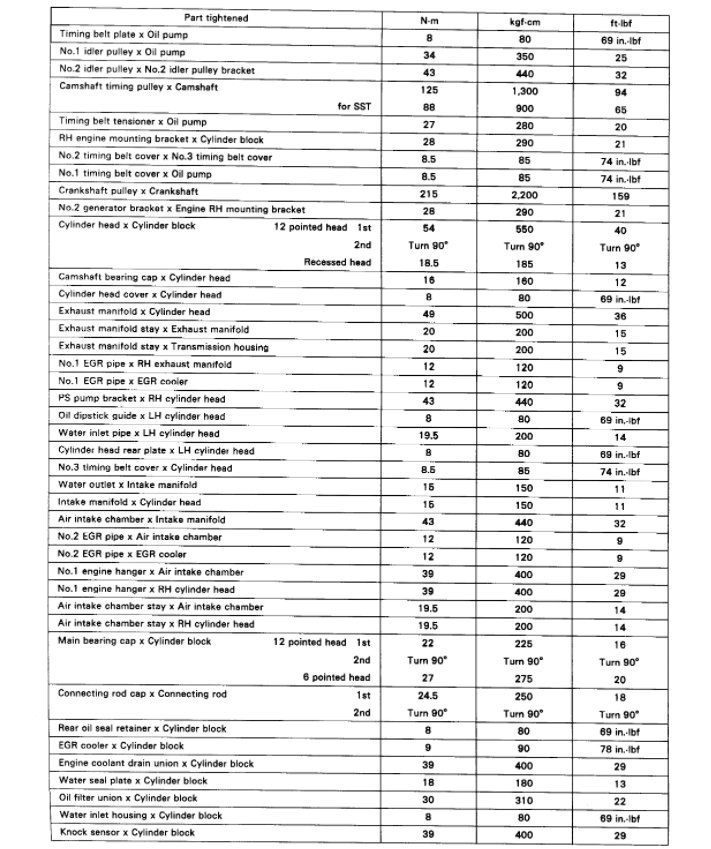

Torque spec for the oil drain bolt and the oil filter needed.

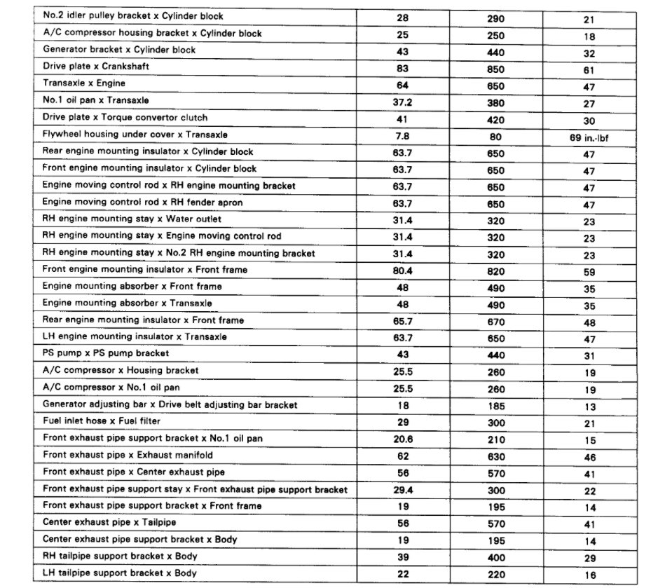

I attached the torque spec for the drain plug below. I also attached the torque specs for the engine itself for you to view.
Drain Plug To No. 2 Oil Pan
33 ft.lb
As far as the oil filter, the spec is hand tight plus 1/2 turn.
