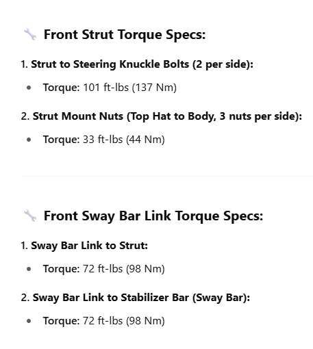

What are the Torque specs for the Front Struts and Sway bar links, please?
Thanks,
Stephen

Here are the torque specs for the front struts and links. Check out the images (below). Let us know if you need anything else.
Image (Click to enlarge)
