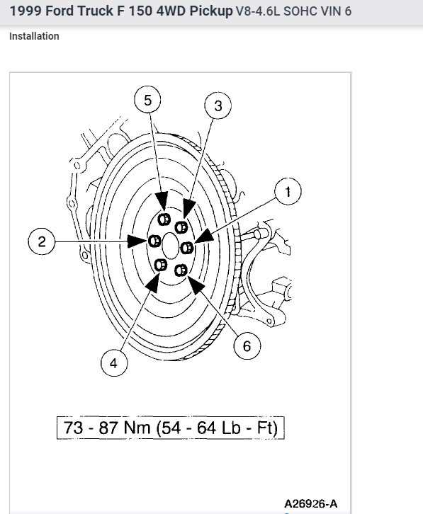

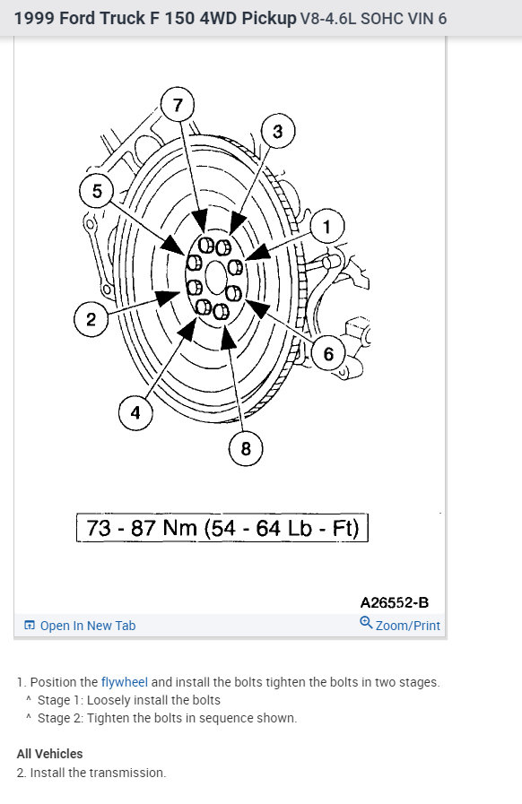

Those bolts should be torqued between 54-64 lb-ft.
They also have a specific sequence for the torque process.

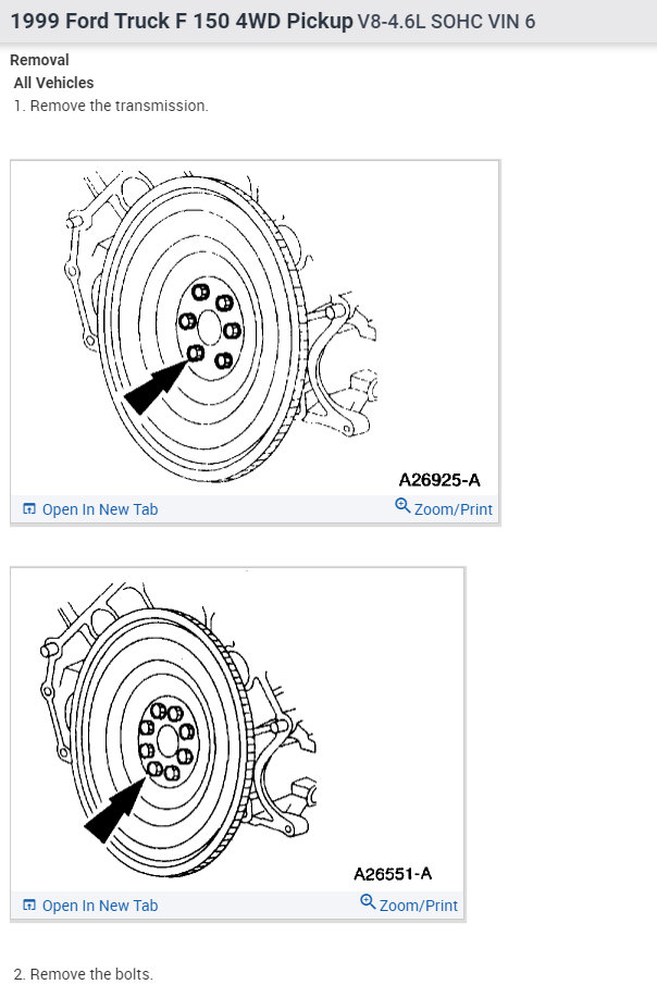

I have attached diagrams showing the torque sequence.
