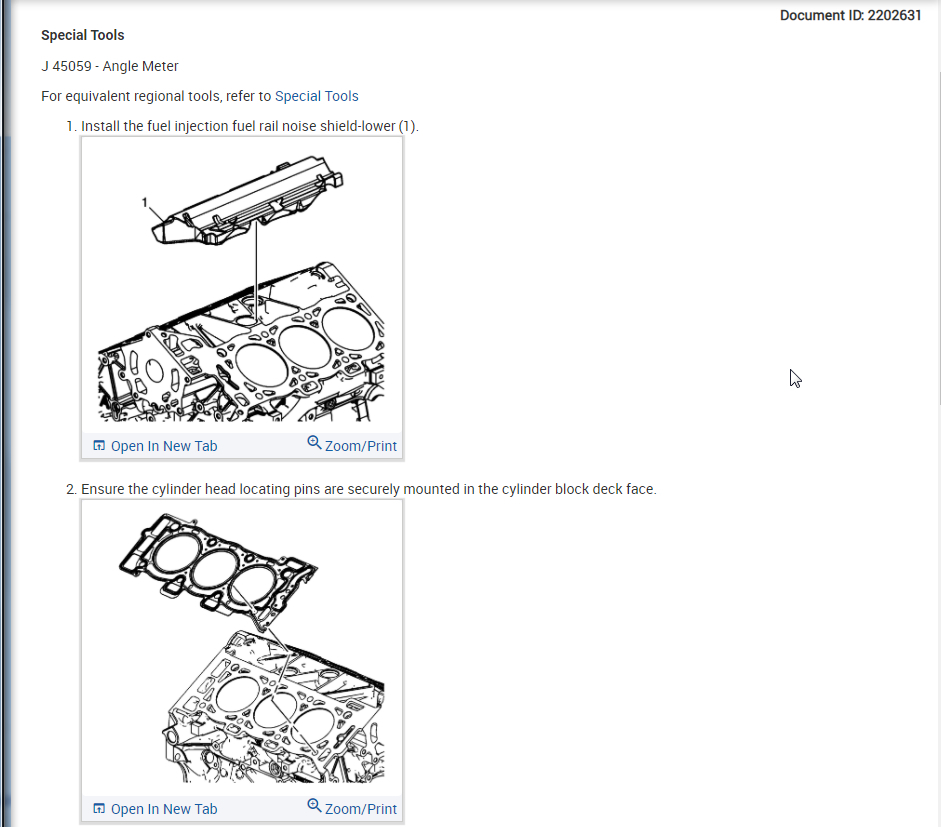

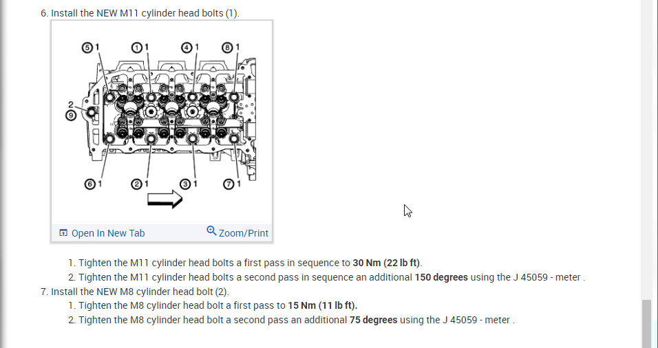

need torque specs.
Mar 31, 2021 at 11:09 AM

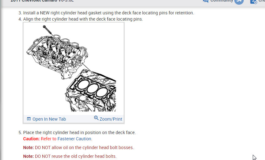

I assume you mean the cylinder head bolt torque specs for the heads? If so, I attached the process below of the installation of a cylinder head.
Please let us know if you need something different. Thanks
