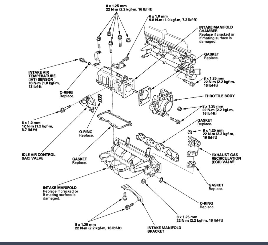

I am about to declare my Air Intake Manifold and I have no idea what the tightening sequence is or the amount of torque needed. It's a 2.3 liter VTEC engine with and automatic transmission.

I attached the torque sequence for you of the upper intake. There is no sequence but I would go from the center out when torquing.
https://www.2carpros.com/articles/replace-intake-manifold-gasket
I would use an inch-pound torque wrench. Most larger ones do not go down this low.
Replace the throttle body gasket as well while you are there.
