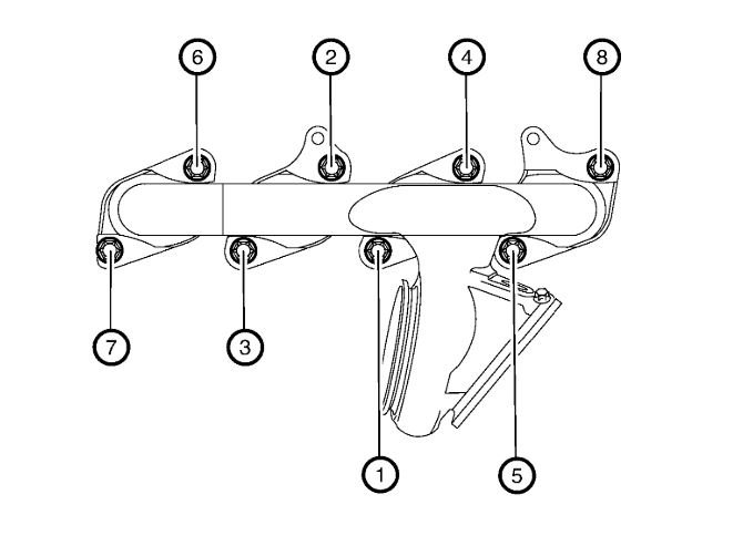

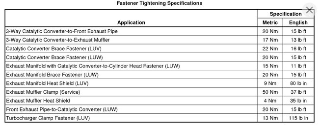

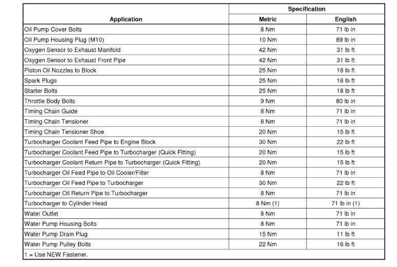

Need the sequence and torque specs for turbo/exhaust manifold for the car listed above lt model.
Aug 18, 2019 at 8:03 AM
Good afternoon,
I attached all the torque specs for you to view. I also attached the sequence for tightening the manifold.
