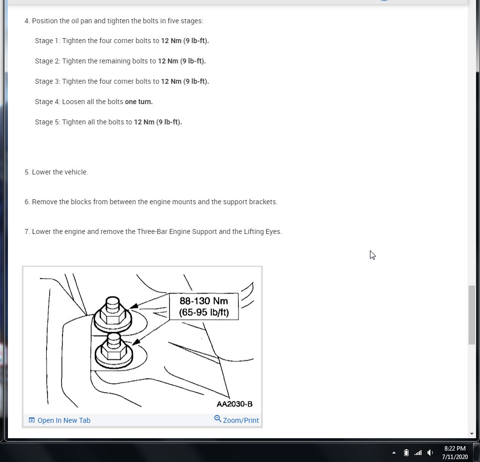

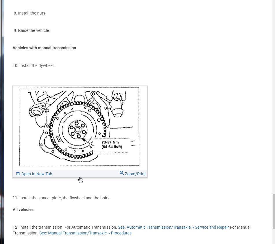

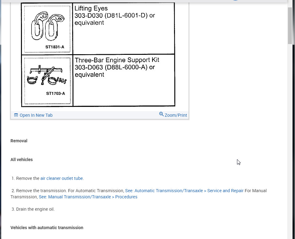

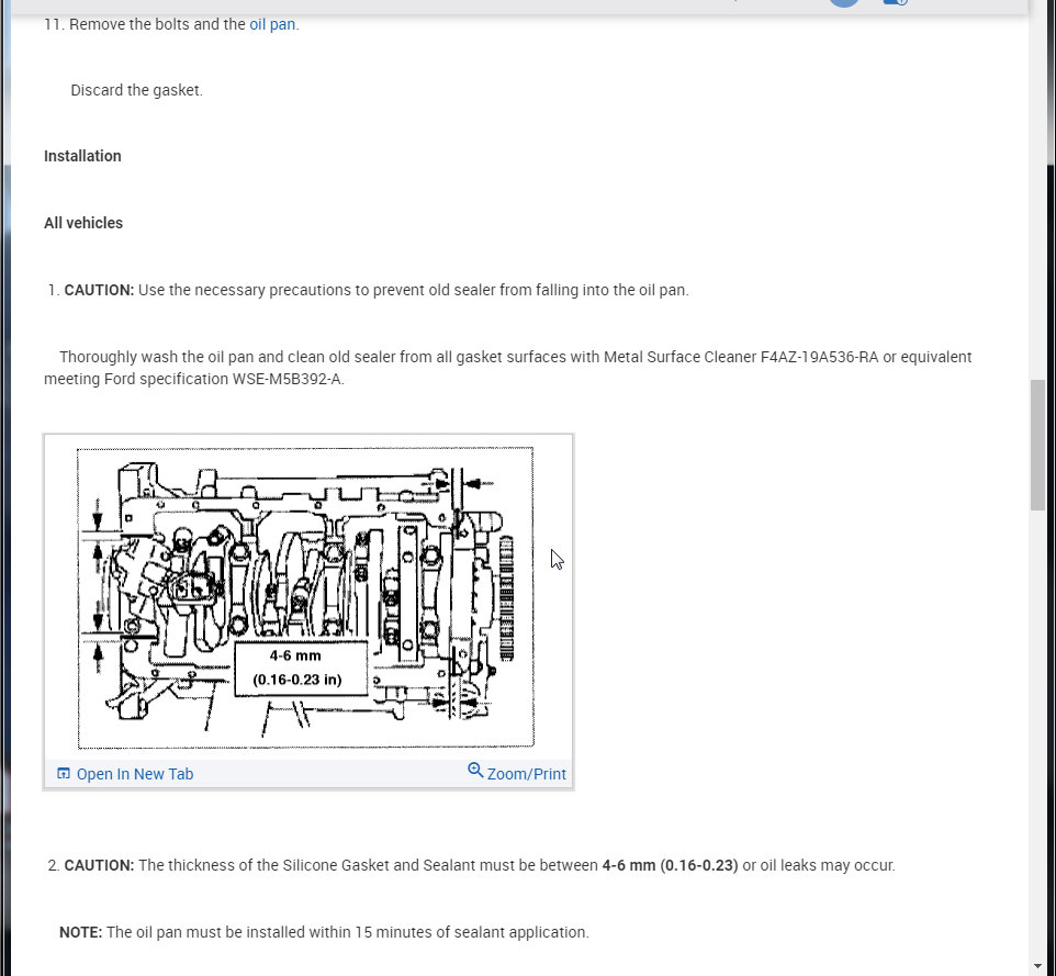

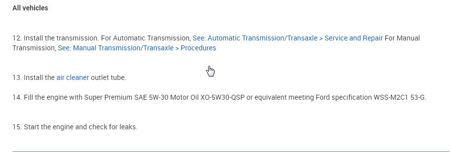

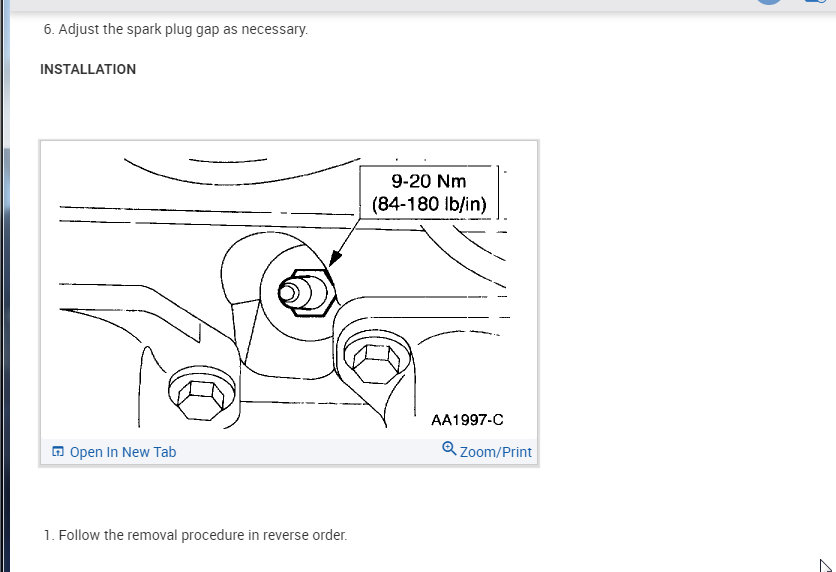

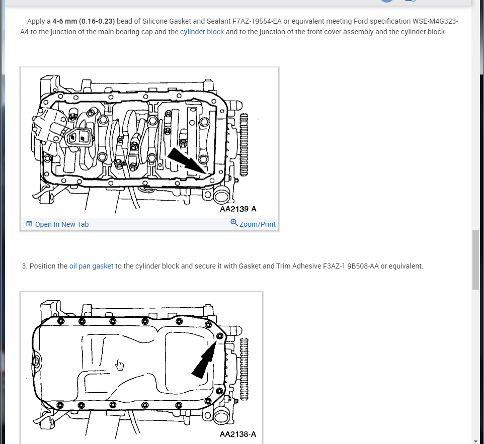

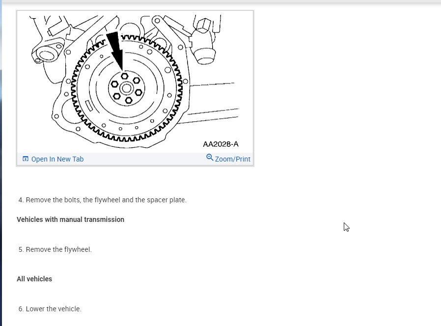

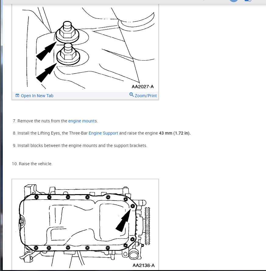

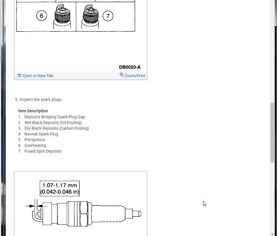

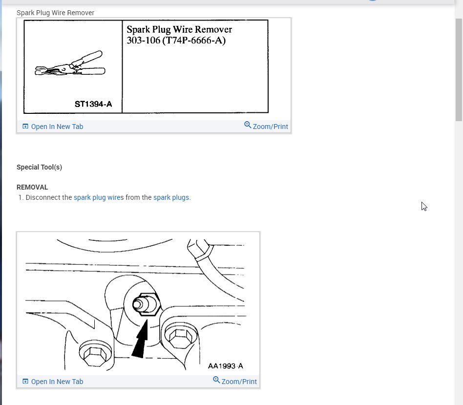

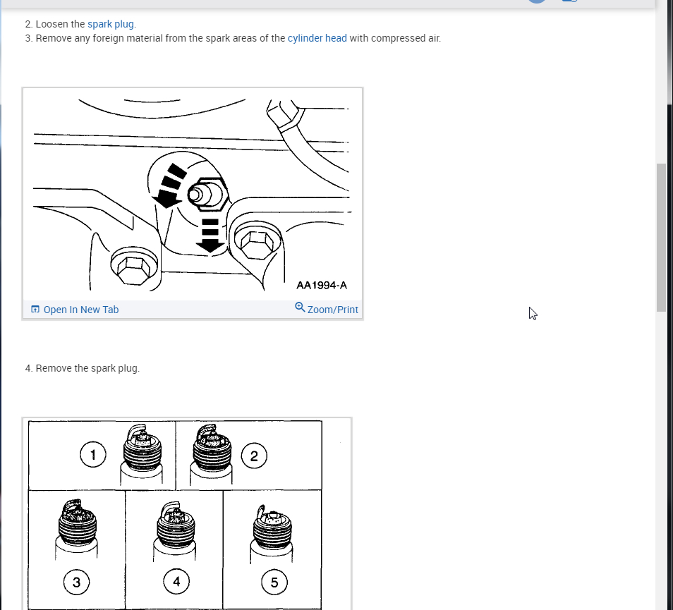

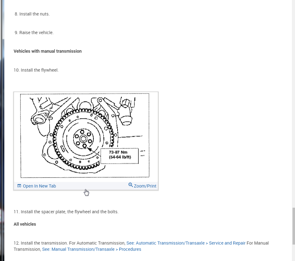

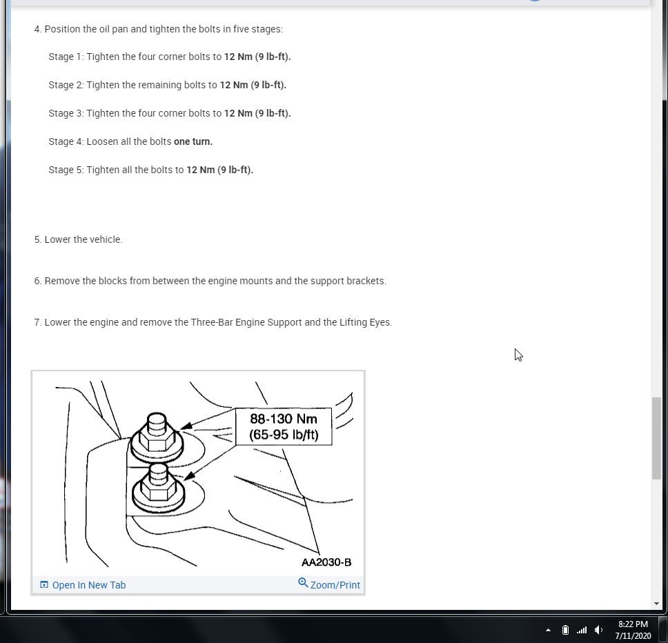

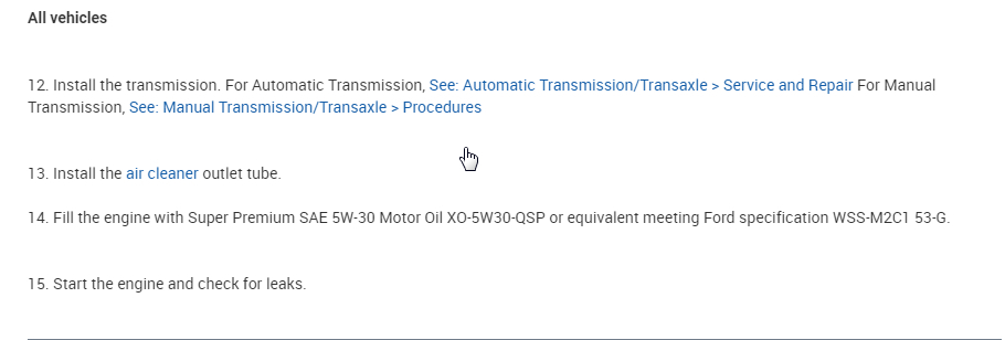

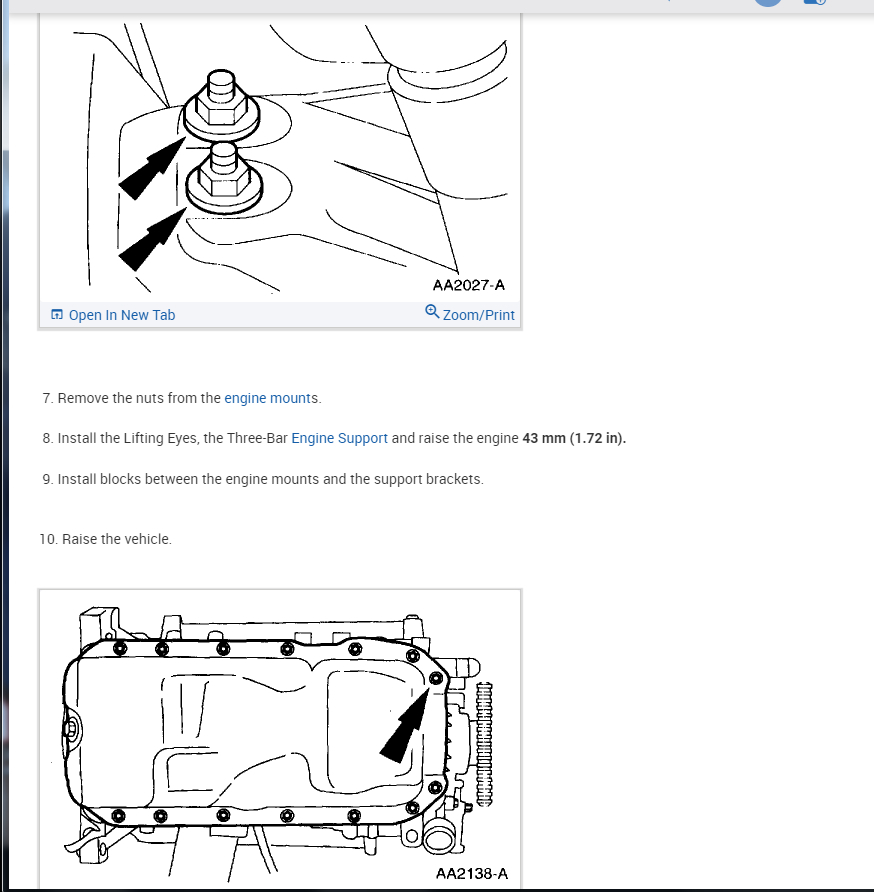

Is there anyway to get a copy of the manual for the oil pan and drain plug procedures and torque and the spark plug please? thank you
Jul 11, 2020 at 9:45 AM
I attached all the info you requested. Let us know if you need other info. Thanks
Jul 11, 2020 at 10:25 AM
SKOOTER24
  • 275 POSTS
I don't see torque for the drain.
Jul 11, 2020 at 10:33 AM
STEVE W.
  • 15,345 POSTS
10 Ft. Lbs. With clean threads and a good gasket.
