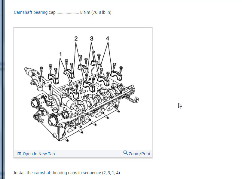

Torque specs for carrier bolts needed
2010 CHEVROLET AVEO
140,000 MILES • 1.6L • 4 CYL • 2WD • AUTOMATIC
LAWRENCE MAJEWSKI
Cam carrier bolts.
Mar 17, 2021 at 8:05 PM
When you say carrier bolts, I suspect you mean the bearing caps? If so, please see below for the detail on this. Let me know if you need something else. Check out the diagrams (Below). Let us know what happens and please upload pictures or videos of the problem. Thanks
