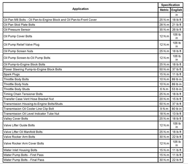

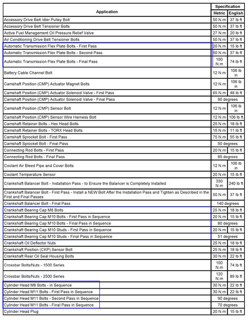

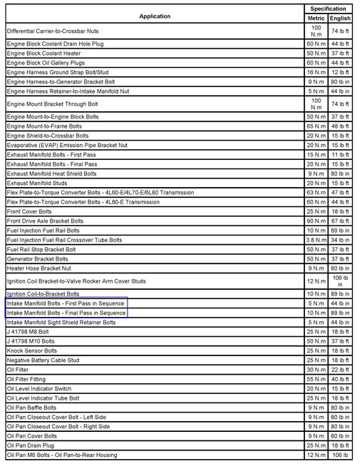

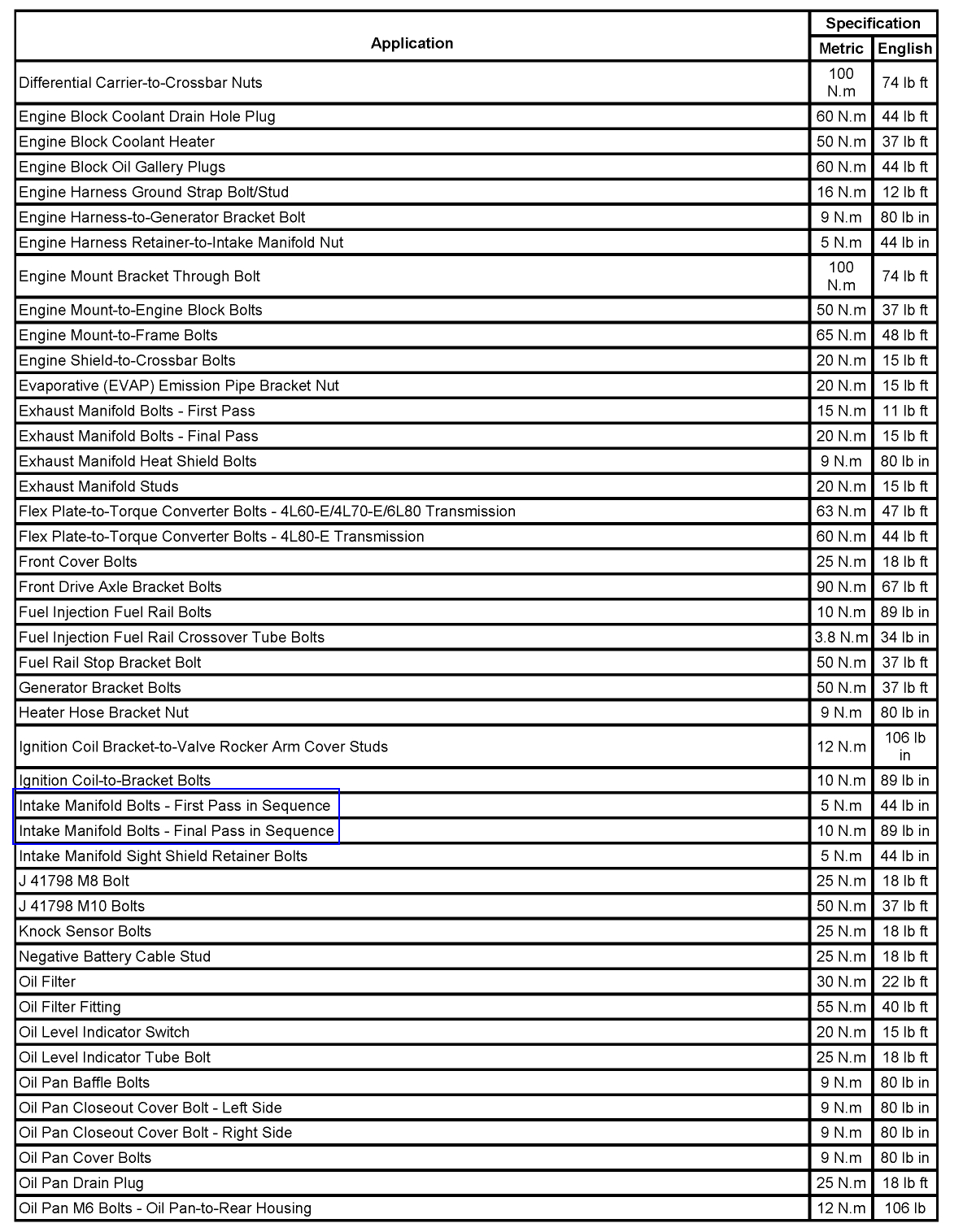

I have the truck listed above SLT model with the Vortec engine LH6. Could you tell me the torque specs for the heads, intake manifold and the exhaust manifold, rocker arms? I am putting on new gaskets.Thank you!
Feb 16, 2018 at 8:19 PM
STEVE W.
  • 15,200 POSTS
Here are all the engine related numbers. That way you have the numbers for the items you did not ask about as well.
