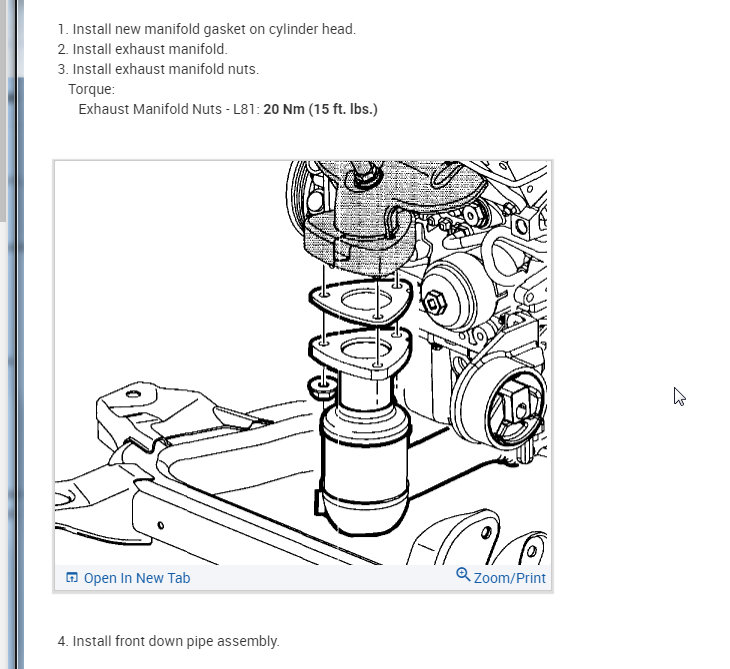

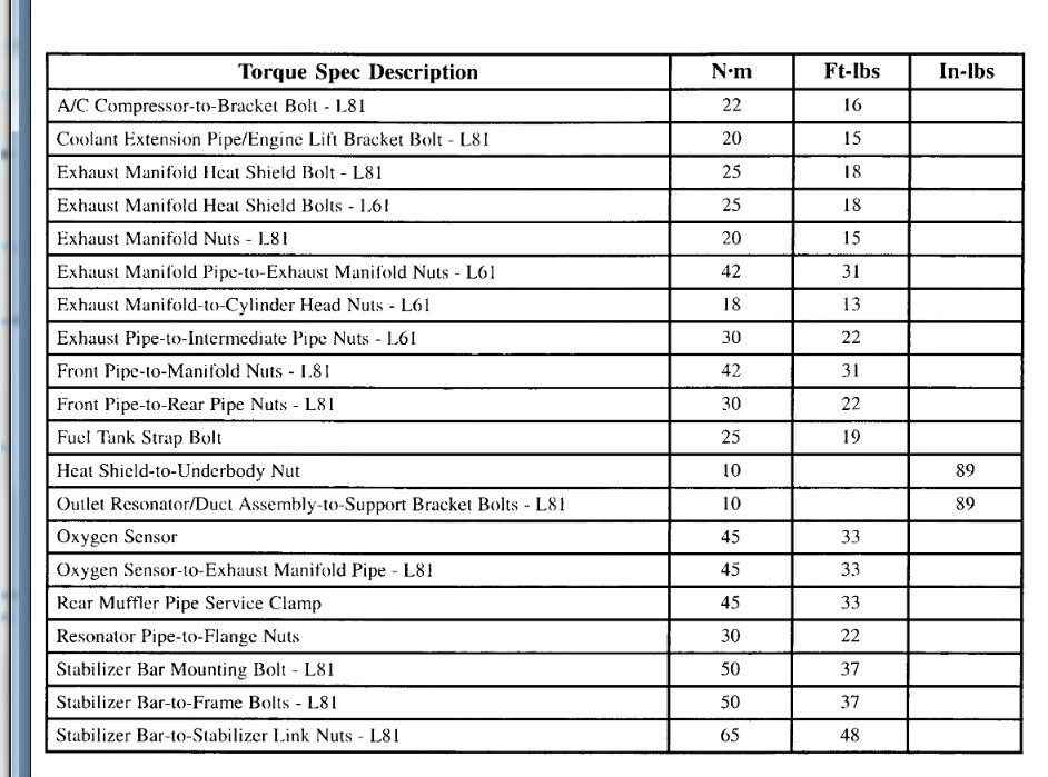

I'm getting ready to replace the exhaust on my car listed above, can you tell me the how much I am supposed to torque the nuts? Need to know how tight the catalytic converter gets attached to the manifold. how tight the two converters bolt together and the rear catalytic converter to the resonator.
Mar 11, 2020 at 8:07 AM
Here are the specs for the exhaust system. Let me know if you need more info. Thanks
