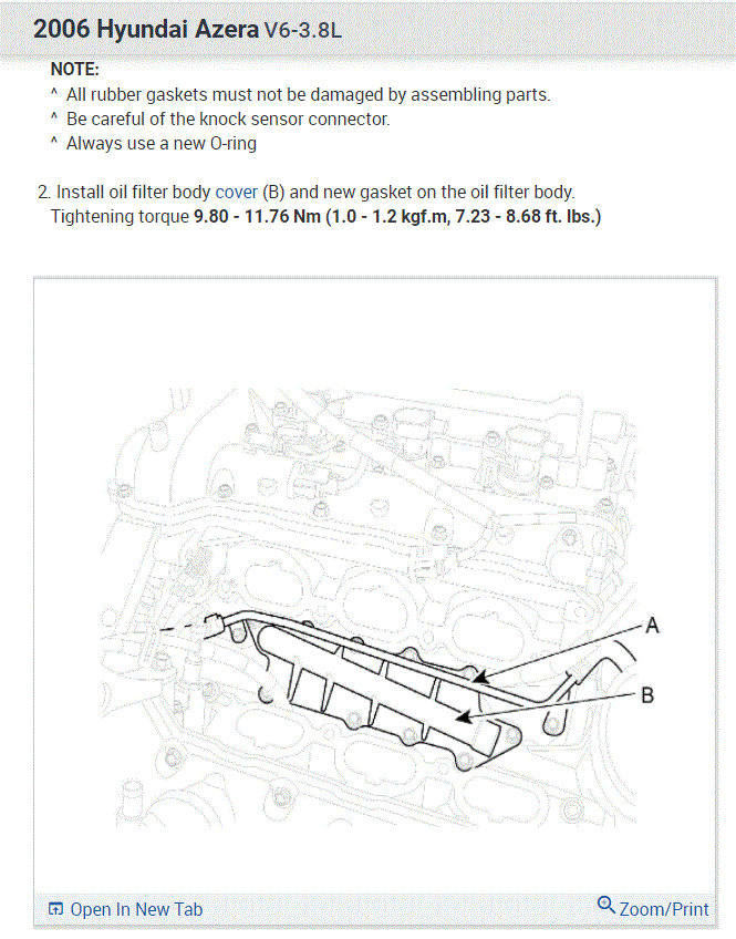

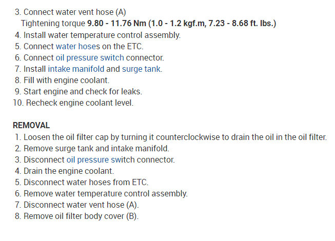

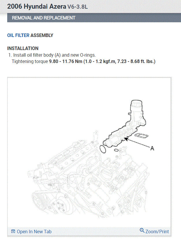

I was needing to know the torque specs for the oil filter housing adapter where it bolts onto the engine block. I've looked all over and even tried calling the dealer service department to no avail. I would really appreciate the help. Thanks.
May 22, 2021 at 6:16 AM
  • 110,240 POSTS

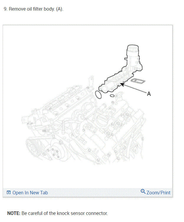

Take a look through the directions I attached below. It explains the removal and replacement of the filter housing. Torque specs are included in the directions.

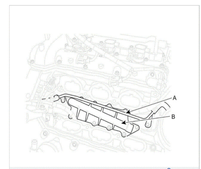

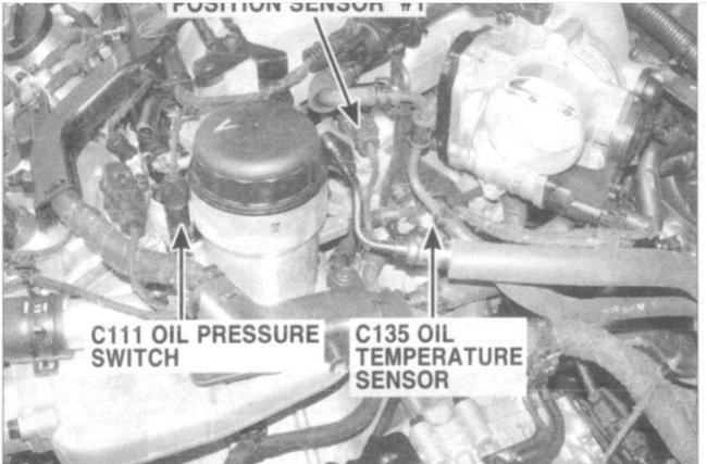

Have you replaced all the o-rings? Were they lubricated with oil prior to installation? Are you certain it is the housing that is leaking and not the oil pressure sensor or oil temp sensor?
See pic below.

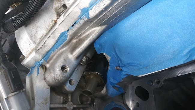

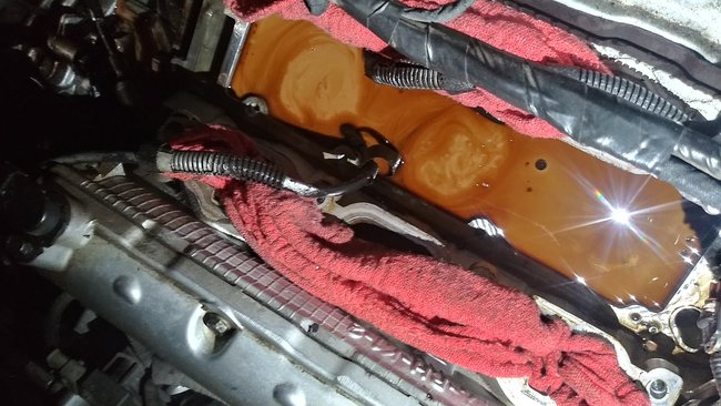

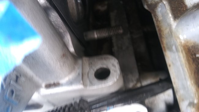

It is definitely leaking from the in between the adapter and the block on the transmission side of the engine. I can visually see the bubbling as it leaks and runs down and out the back. I did oil the gaskets the first time and i still had a leak, although it was the slowest of the three times i took it all apart. The second time i used silicon in an attempt to try and seal around the gasket. I was careful to properly apply it to the outer edges only. It was after this second attempt that initially contacted you. It still leaked. The third and last time i once again used silicon. I'm guessing that was incorrect as per your reply. The engine definitely has signs that it has been worked on in the past, I'm certain heads were removed at some point, there are even a few bolts missing. I'll send a few pics. Should I only use oil to lube the gaskets just before I install the oil adapter? The first two pics are of the suspected missing bolts, the second is showing the area it leaks from and the last is the leak from when i first initially took it apart.

Before you put it together again, confirm the adapter and where it mounts are flat and not warped. Since you have already done everything, I have a feeling that is the problem. Something must be warped.
