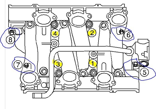

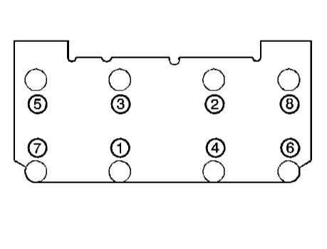

Here are the specs for the head, cam sprocket and intake and exhaust manifolds..
Head - First pass to 44 Ft Lb. Then turn 95 degrees bolt pattern attached

Intake manifold - Lower Center - First pass 62 inch pounds, Second pass 115 inch pounds= yellow
Intake manifold - Lower Corners - First pass 115 inch pounds, second pass to 18 Ft Lb= blue
Upper intake - 18 Ft. Lb.
Exhaust manifold - 12 Ft Lb
