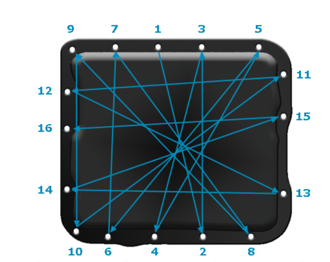

i am going to replace transmission filter. I would like to know the torque specs of the 3 bolts holding the filter. also torque specs of the 18 bolts of the transmission pan.

Torque .................... 5.3 Nm (54 kgf-cm, 47 inch lbs.)
Please note that is inch pounds and not foot pounds. Don't over tighten it or damage to the gasket can occur or you can strip the threads in the aluminum pan.

Okay, i found information online about the torque spec of the filter bolts. it says the torque is 7 ft lbs = 84 in lbs. does it sound right? also is there a sequence to torque the fluid pan?

Yes, that is very possible. As far as tightening the pan, tighten them in a crisscross pattern. If you look at pic 1 (not the same pan) it shows the crisscross pattern I am referring to. I was able to get a general pic from online. Hope it helps.
