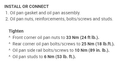

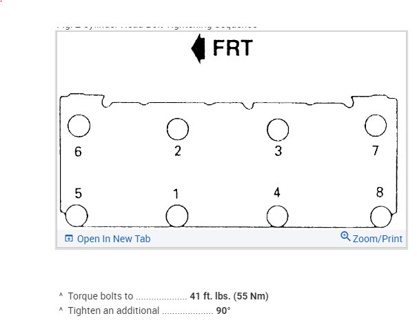

Where can i find the engine torque specs? i am rebuilding another 3.4 because the last one blew up and i can't find any torques; like head bolts or oil pan bolts.

I've attached 2 pictures below of the torque specs you requested.Let me know if you need any others.Hope this helps and thanks for using 2CarPros.
