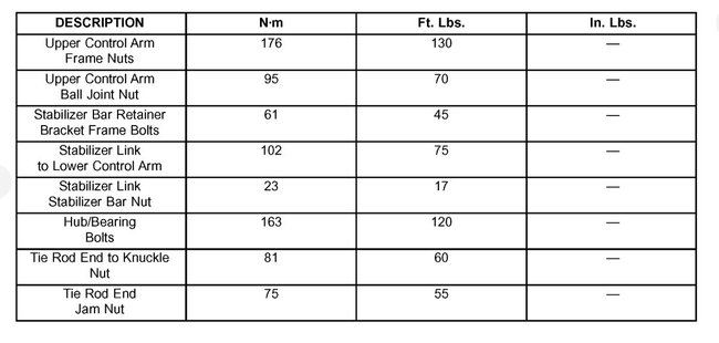

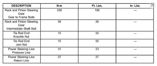

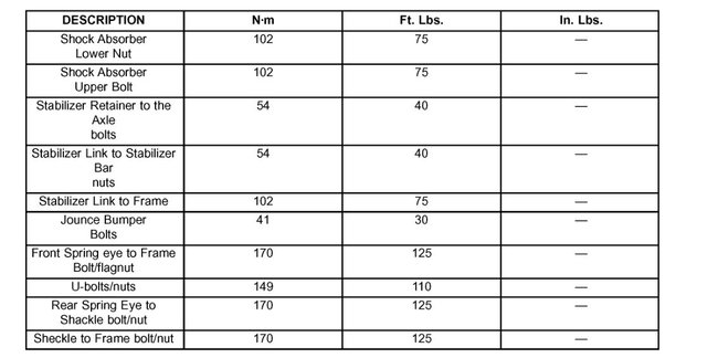

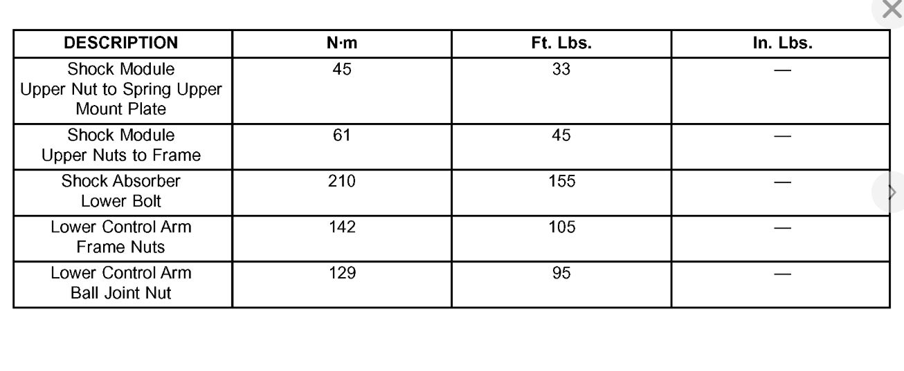

Just trying to get torque specs for:
Upper and lower ball joints.
Tie rod ends .
Strut upper nuts.
Shocks in rear.
Oct 1, 2018 at 4:26 AM
Good afternoon.
Attached are torque specs for the repair that you are performing. Check out the diagrams (Below). Please let us know if you need anything else to get the problem fixed.
