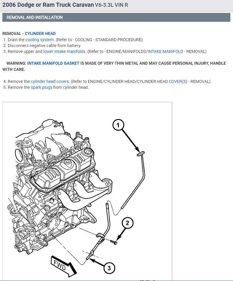

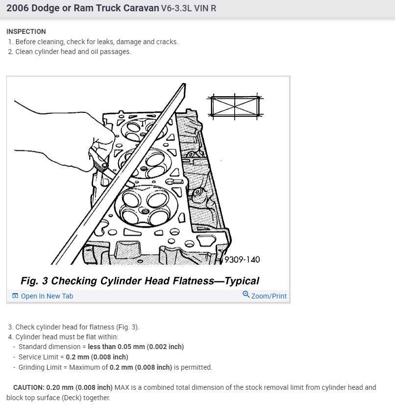

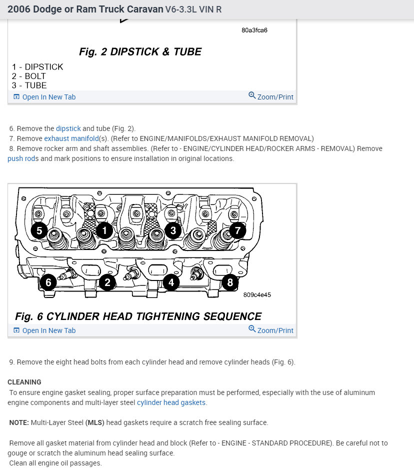

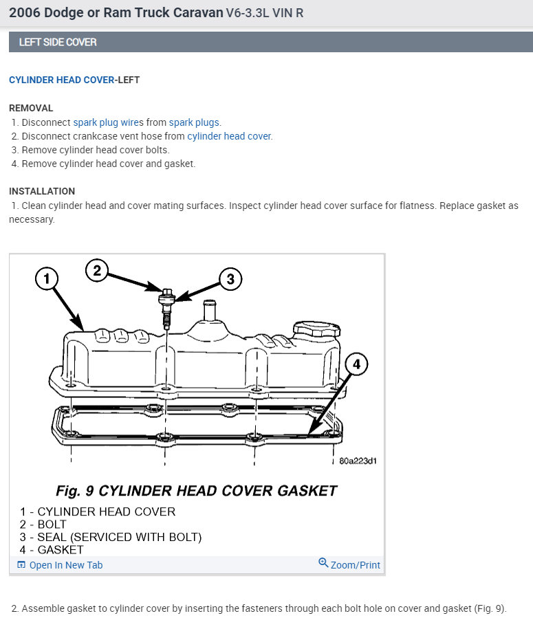

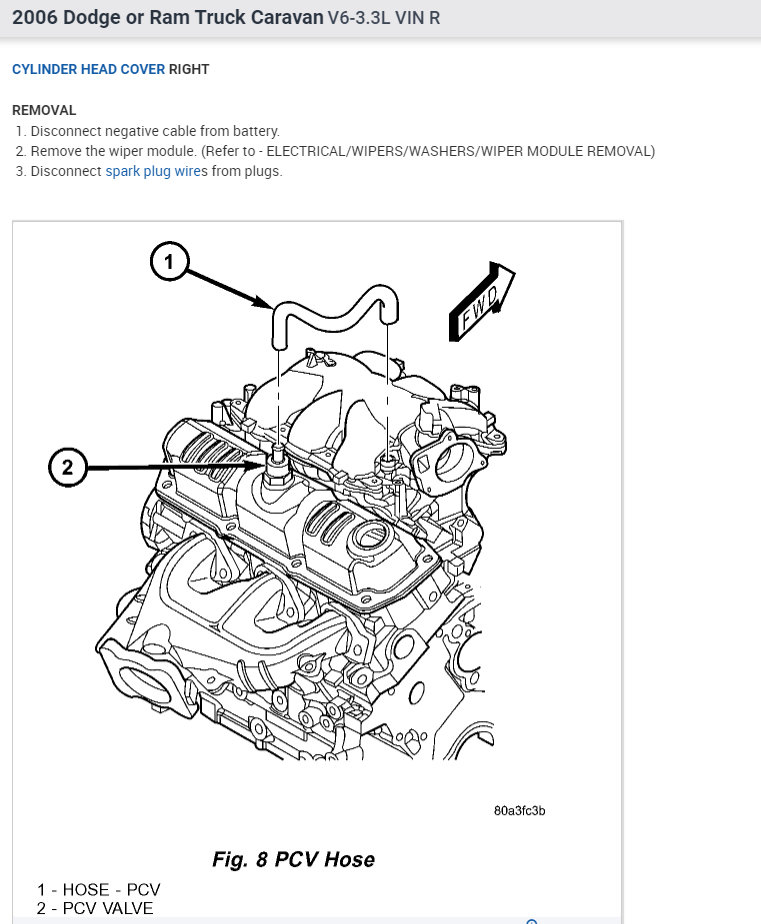

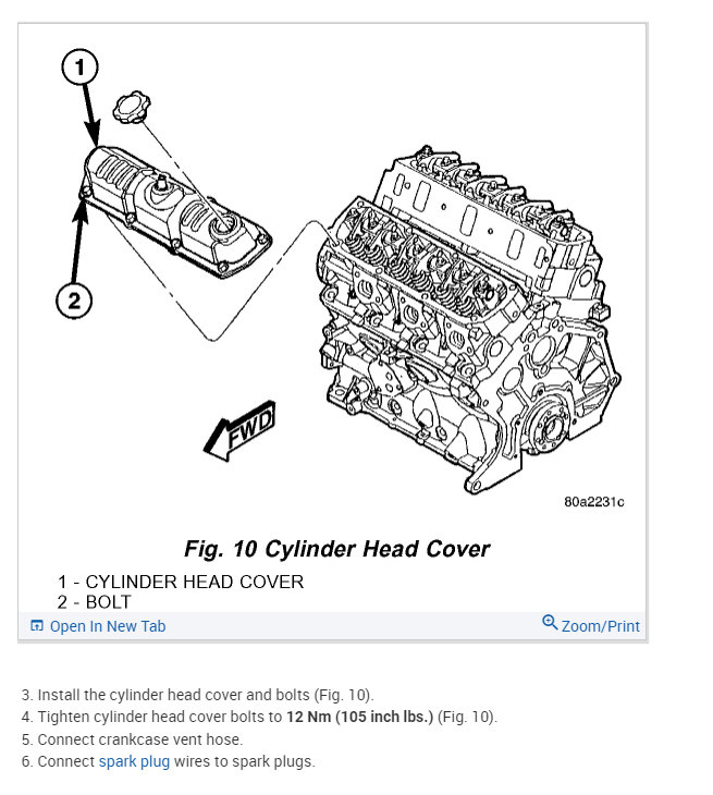

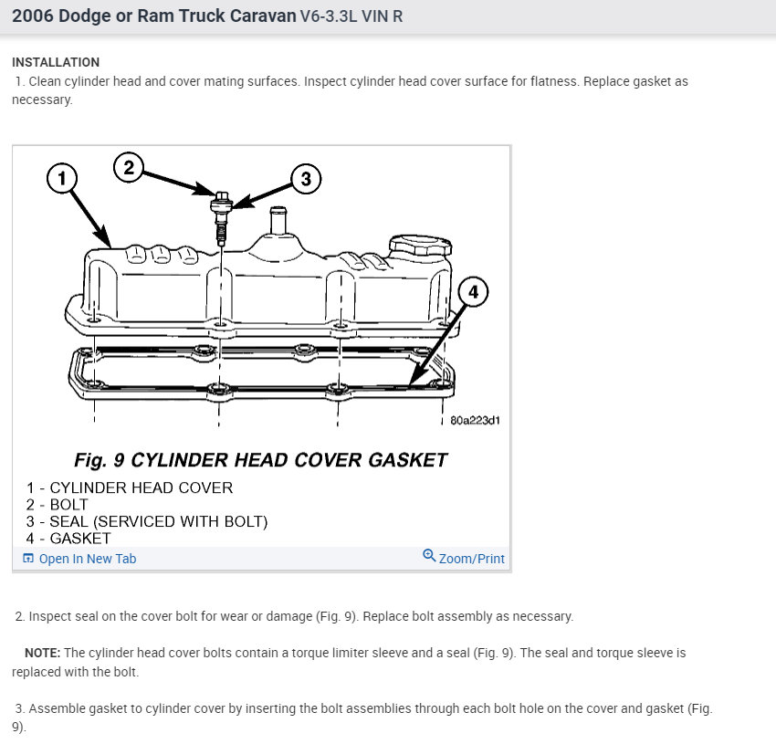

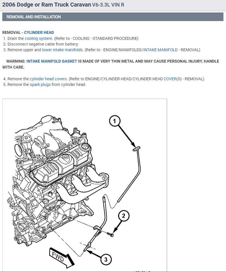

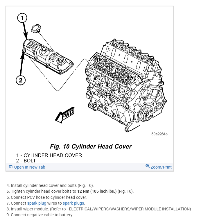

What is the torque specs for replacing head gaskets? torque specs on heads valve covers, the whole nine yards.
Jul 7, 2022 at 3:51 PM
SQM
  • 6,383 POSTS

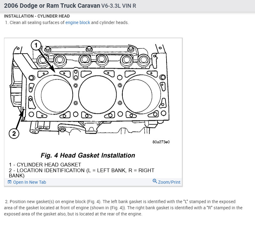

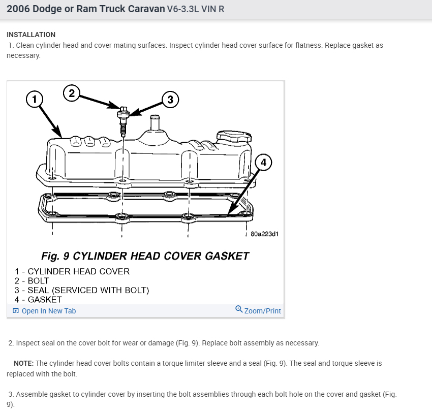

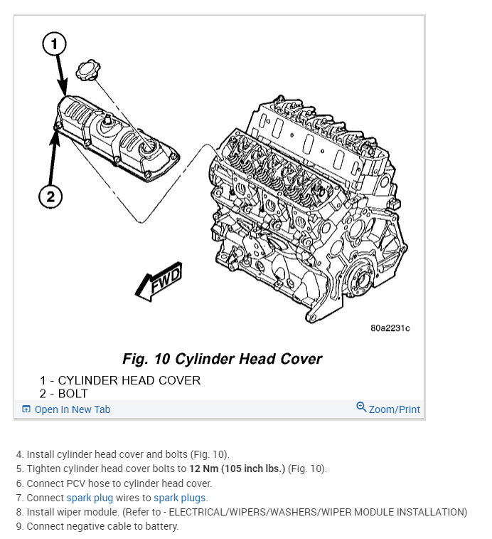

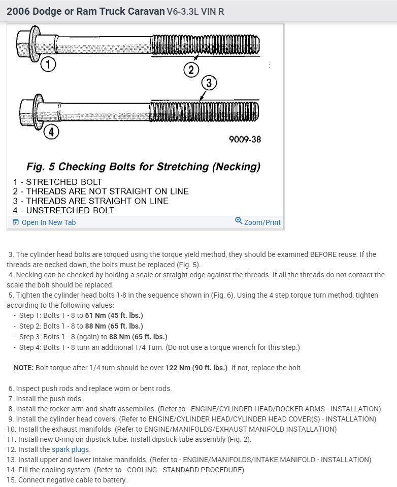

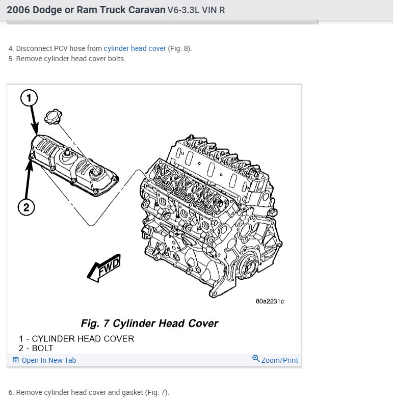

See attached for the cylinder head torque specifications as well as the torque sequences. Also included are the valve cover instructions as well.
Let me know of any questions.
