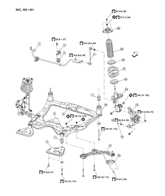

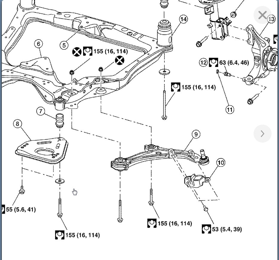

Need torque specs for front lower control arms.

I attached the exploded view which shows the torque specs (second number). Let me know if you have more questions. Check out the diagrams (Below). Please let us know what happens. Thanks
