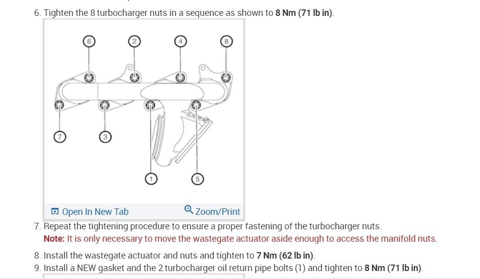

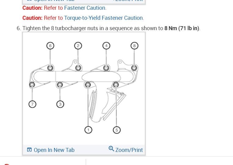

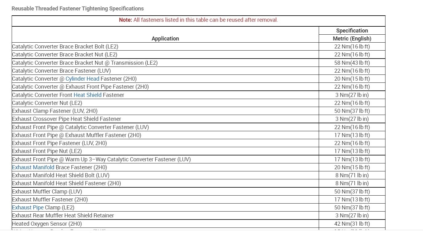

Replacing complete exhausts manifold/turbo in need of specs.
Mar 9, 2022 at 4:19 AM
Good afternoon,
I attached the torque specs for you below. You must use new nuts for this. You cannot use the old nuts. Check out the diagrams (Below). Let us know what happens and please upload pictures or videos of the problem.
