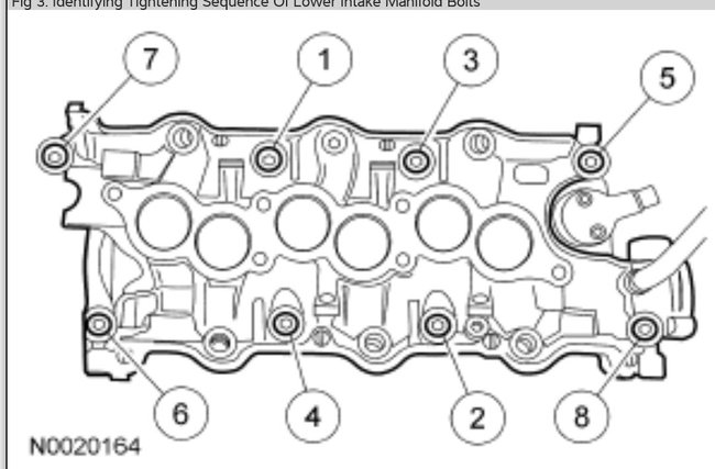

Lower intake manifold torque specs.
Oct 18, 2016 at 6:24 AM
HMAC300
  • 48,601 POSTS
tighten in sequence stage 1-11 lbs stage 2-24 lb.
Oct 18, 2016 at 9:42 AM
ROBERT GREEN
Thank you, I thought so.

SCOTTY DEE
  • 592 POSTS
Upper Intake- torque at 10 Nm (89 in. lbs.). Work from the center out.
Lower Intake
Stage 1: Tighten to 15 Nm (11 ft. lbs.).
Stage 2: Tighten to 32 Nm (24 ft. lbs.).
Feb 3, 2021 at 8:00 AM (Merged)

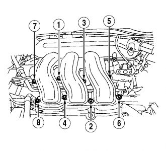

AQUARIUM123
I need the torque & sequence for the upper intake manifold for my 3.0 dual Overhead Cam- Plastic Manifold with 8 bolts?
Feb 3, 2021 at 8:01 AM (Merged)

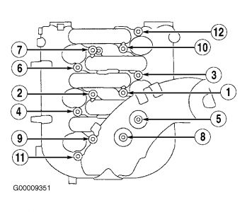

FITZ04
Engine Mechanical problem
2000 Ford Taurus 6 cyl Two Wheel Drive Automatic
need toqure specs and sequence to tighten manifold
DAVE H
  • 13,383 POSTS
3.8L Upper Intake Manifold Bolt...............Lbs. Nm. 1st Step........................................53.. (6) 2nd Step.......................................70 ..(8 3rd Step..............................Additional 90 Degrees
https://images.2carpros.com/forum/automotive_pictures/266999_man_1.jpg

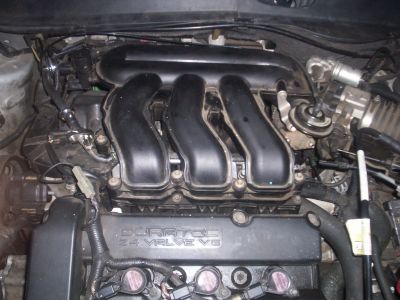

FITZ04
thanks for the reply but this is not the type of maniford that i have, after looking at the engine this morning it is a Duratec 24 valve v6, it has 8 bolts. my fault i did not say what engine i had
https://images.2carpros.com/forum/automotive_pictures/317531_002_2.jpg

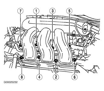

DAVE H
  • 13,383 POSTS
Intake Manifold Bolt (Upper And Lower) Lbs89 Nm(10)
https://images.2carpros.com/forum/automotive_pictures/266999_upper_1.jpg
