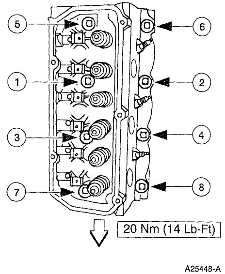

I need the torque specifications for my truck listed above head gaskets.
Oct 7, 2017 at 3:12 AM
STEVE W.
Experienced Mechanic
15,387 POSTS
Follow the same pattern through the first steps.
14 ft. lb., then
28 ft. lb., then
36 ft.lb.
Now get out the torque angle gauge.
Torque 2,4,6,8 to 175 degrees,
Then torque 1,3,5,7 the same.
