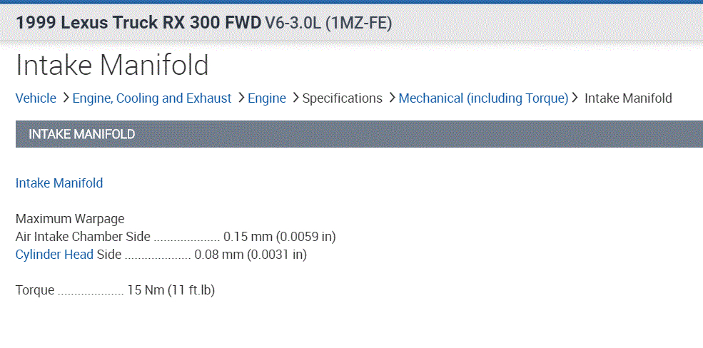

Vehicle listed above need torque specs for 1MZ-FE GF-MCU10W-AWPGK. Rebuilding and overhauling the engine. please.

The Harrier isn't offered in the us. However, the Lexus RX is and it has the same engine (IMZ-FE). I hope this helps. What I have is broken down by engine components. The attached pics will correlate with the directions.

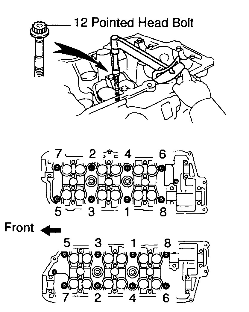

c) Install and uniformly tighten the cylinder head bolts on each cylinder head, in several passes, in the sequence shown, then repeat for the other side, as shown.
Torque: 54 Nm (550 kgf-cm, 40 ft. lbs.)
If any of the cylinder head bolts does not meet the torque specification, replace the cylinder head bolt.

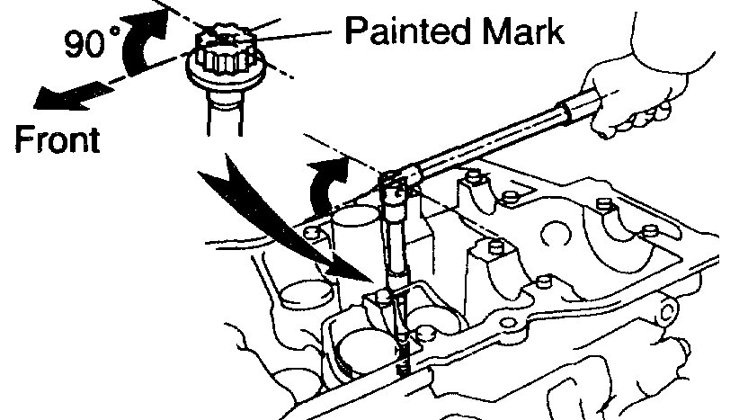

d) Mark the front of the cylinder head bolt head with paint.
e) Retighten the cylinder head bolts by 90° in the numerical order shown.
f) Check that the painted mark is now at a 90° angle to the front.

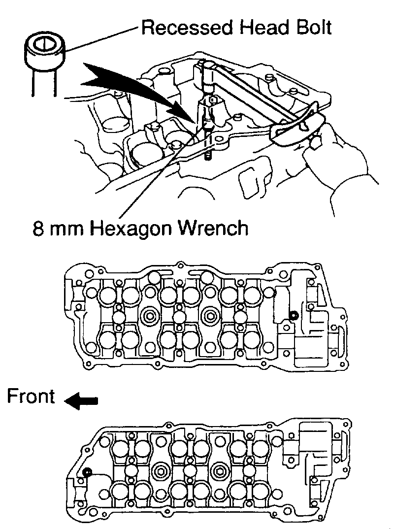

INSTALL RECESSED HEAD CYLINDER HEAD BOLTS
a) Apply a light coat of engine oil on the threads and under the heads of the cylinder head bolts.
b) Using an 8 mm hexagon wrench, install the cylinder head bolt on each cylinder head, then repeat for the other side, as shown.
Torque: 18.5 Nm (185 kgf-cm, 13 ft. lbs.)

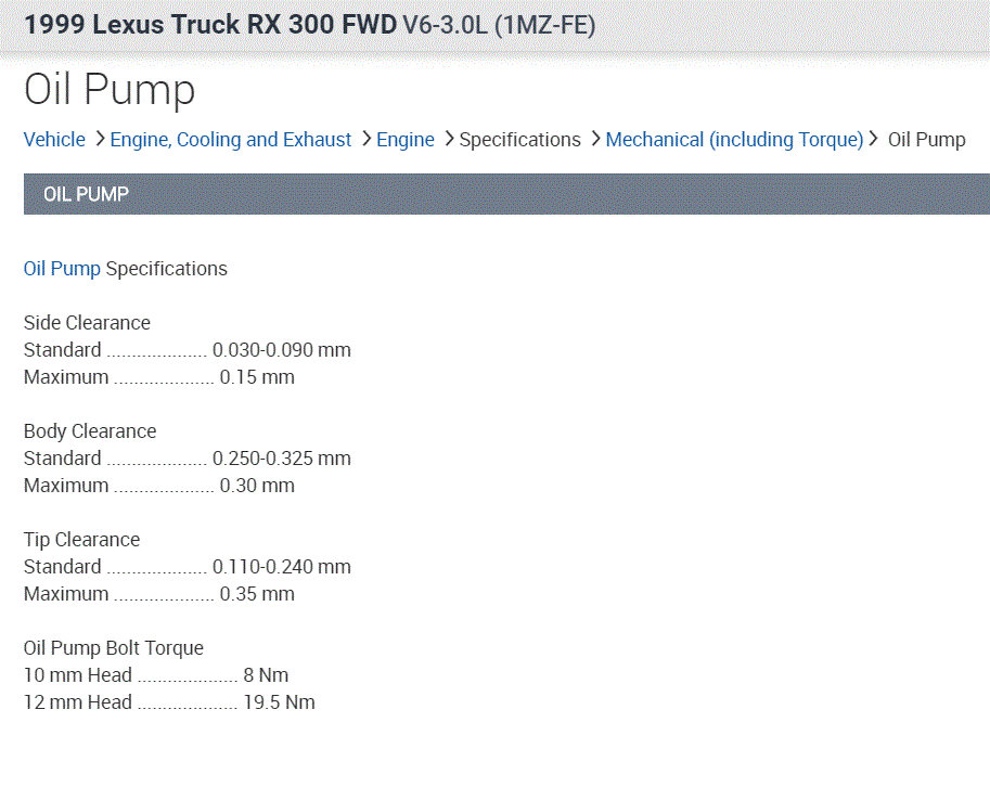

See pic 4 for oil pump specs.

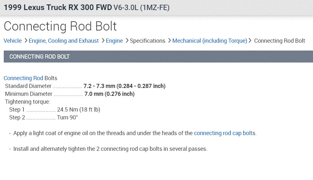

Pic 5 for connecting rods

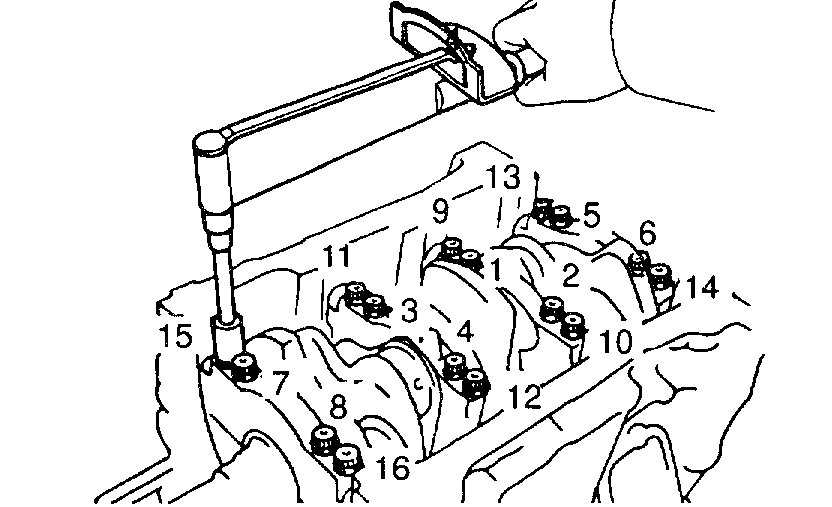

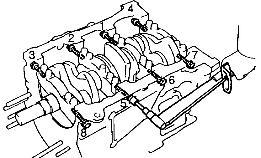

Vehicle Engine, Cooling and Exhaust Engine Specifications Mechanical (including Torque) Crankshaft Main Bearing Service Specifications
SERVICE SPECIFICATIONS
Main Bearing Cap Bolts
12 Pointed Head Bolts
Standard Diameter .................... 7.500 - 7.600 mm
Minimum Diameter .................... 7.20 mm
Tightening Torque

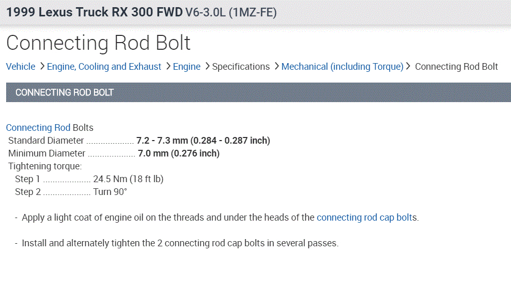

pic 6
Step 1 .................... 22 Nm (16.22 ft.lb.)
Step 2 .................... Turn 90 degrees
Hexagon Head Bolts
pic 7
Torque .................... 27 Nm (20 ft.lb.)
Main Bearing Oil Clearance
Standard
No.1 and No.4 Journals .................... 0.014-0.034 mm
No.2 and No.3 Journals .................... 0.026-0.046 mm
Maximum
No.1 and No.4 Journals .................... 0.05 mm
No.2 and No.3 Journals .................... 0.06 mm

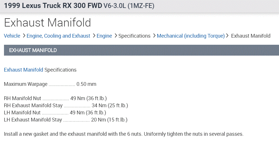

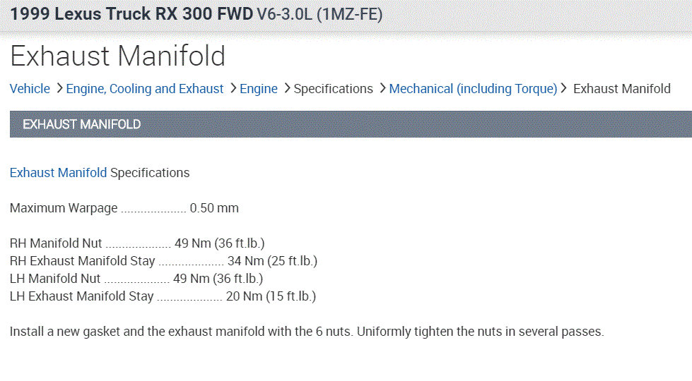

Exhaust manifold see pic 8

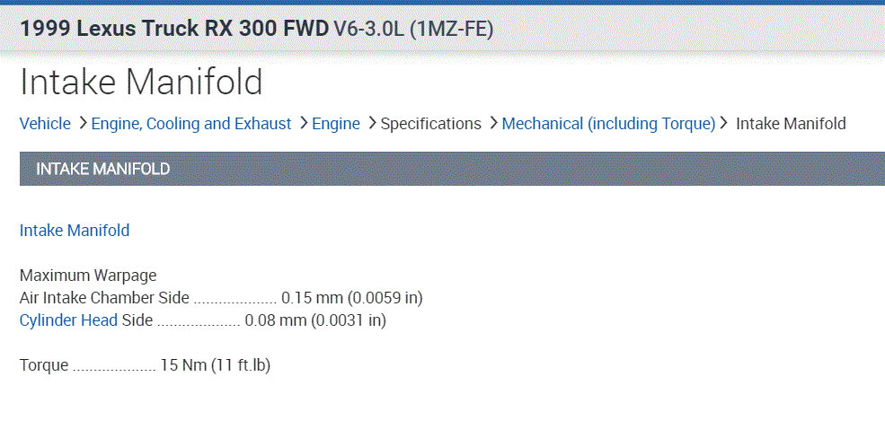

Intake Manifold see pic 9

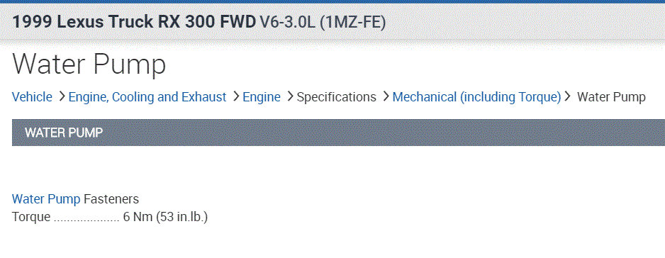

Water pump see pic 10

Let me know if this helps. If you have other questions or something specific, let me know.
