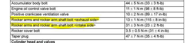

Torque Specifications for the intake and exhaust for the rocker arm shaft bolts needed
2004 MITSUBISHI GALANT
180,000 MILES • 2.4L • 4 CYL
LILDWAYNE0715
I know the intake rocker arm shaft bolts are 23ft-lbs. I just need the torque specification for the exhaust rocker arm shaft side. Please and thank you.
Nov 17, 2021 at 2:33 PM
  • 110,194 POSTS
It took a while to find it, but I did. LOL If you look at the attachment below, it provides the torque specifications you're looking for.
See pic below.
