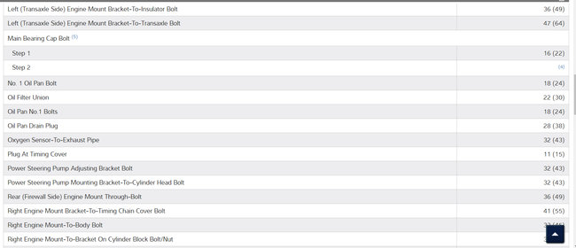

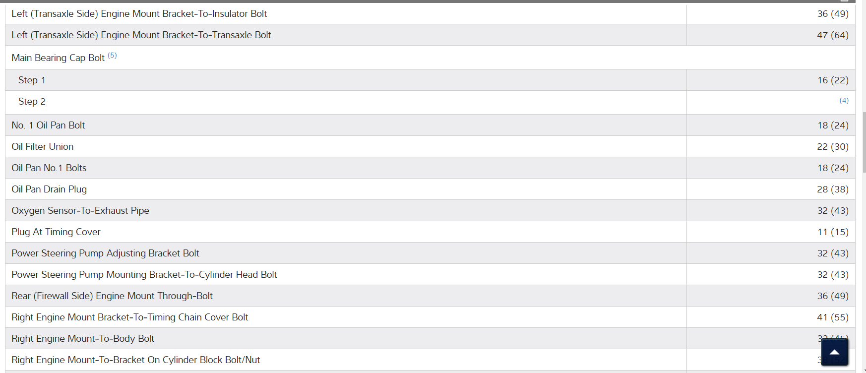

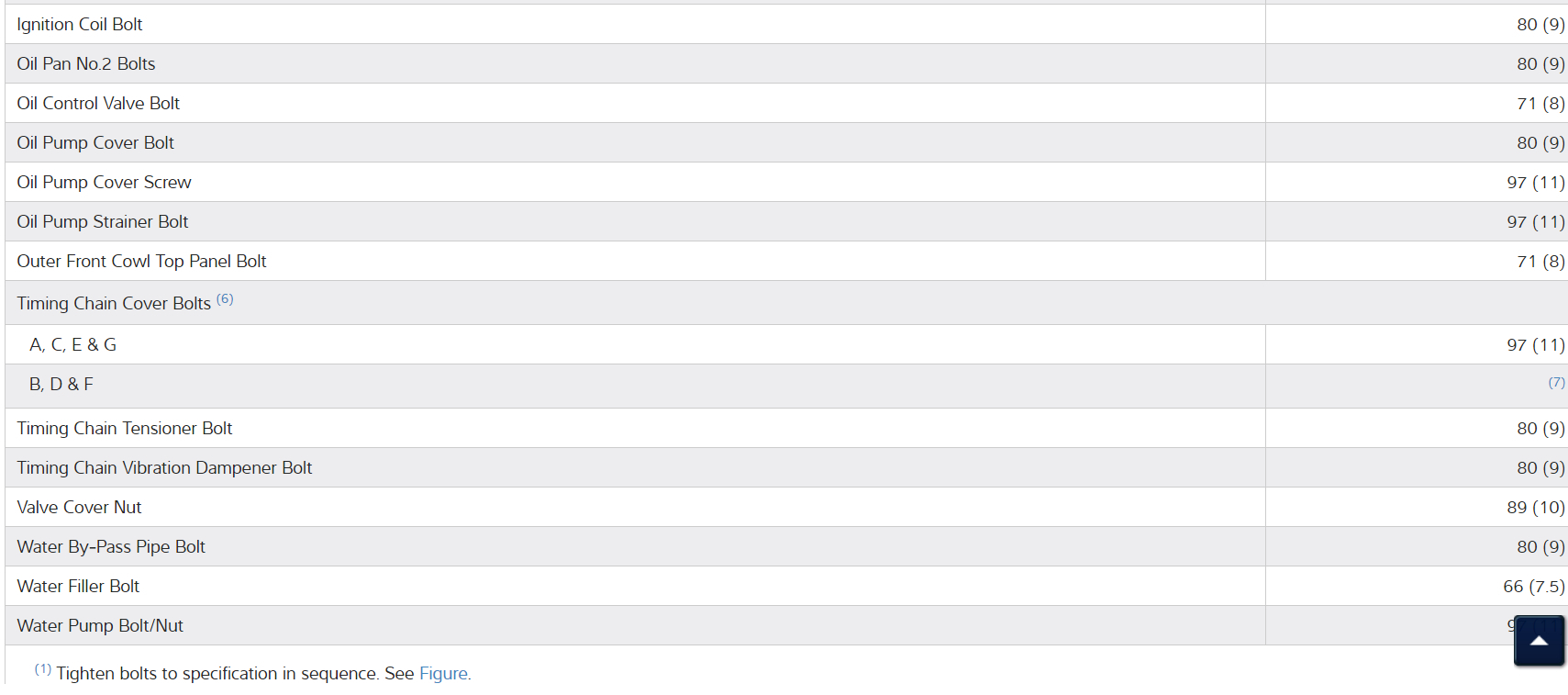

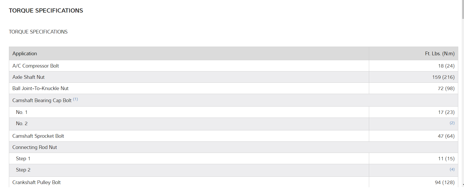

Can you kindly help with torque specifications for my car? For big ends and cylinder head 1z and 1zz.
Feb 28, 2019 at 6:12 AM
SCGRANTURISMO
  • 4,897 POSTS

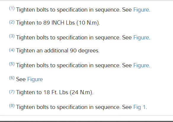

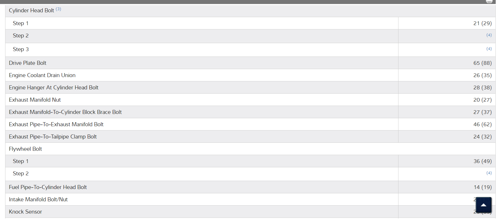

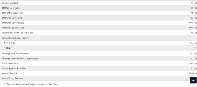

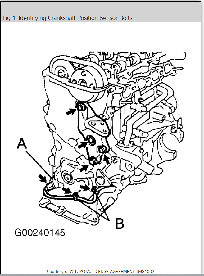

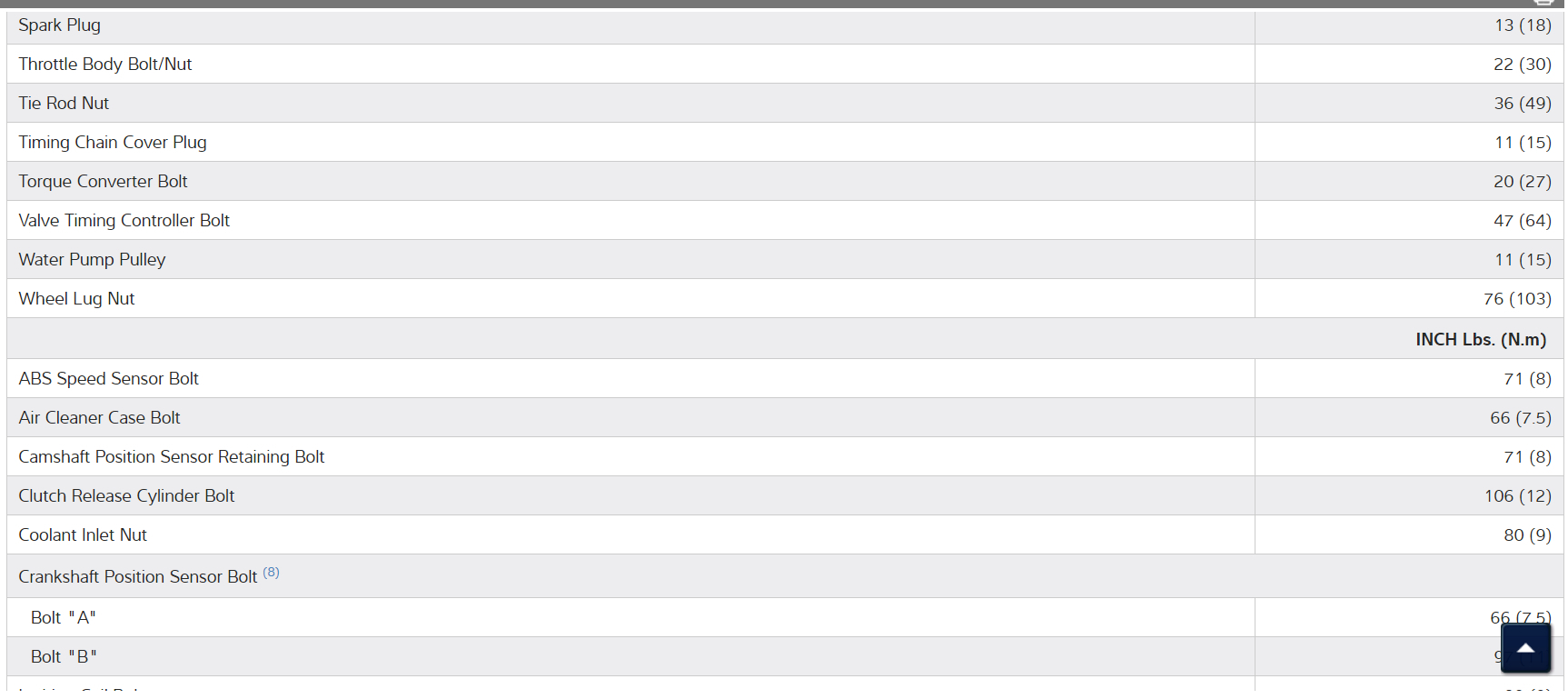

Although that model of Toyota is not sold here in the United States I did manage to pull up the specs on a Toyota Echo. that is sold in the United States and has a 1.5L power plant. I would imagine they are the same engine. I have shot all of the engine torque specs to you in the diagrams down below. I hope this helps.
