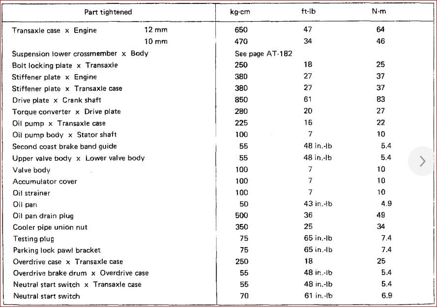

What are the torque specifications for putting back the transmission?
Apr 23, 2019 at 10:55 PM
Hi Mike,

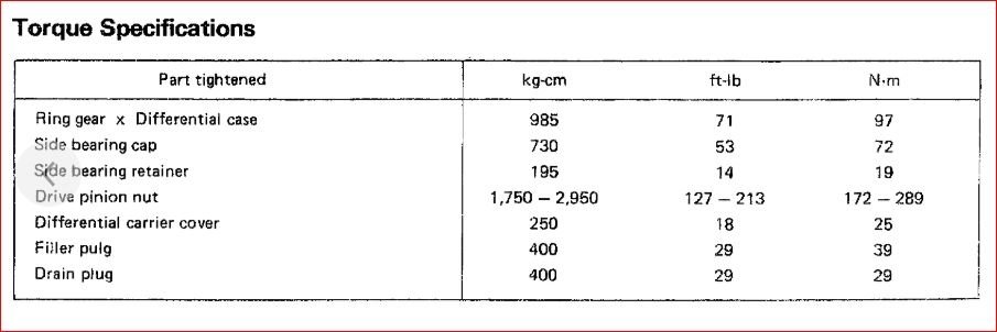

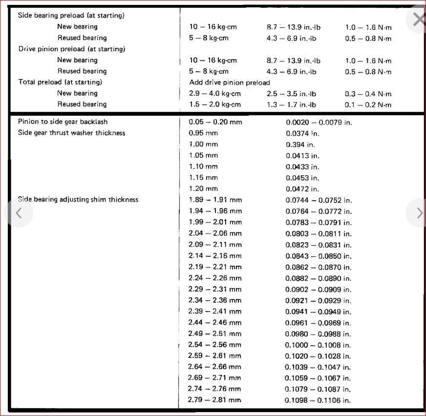

I assume you are talking about the trans case to the engine? If so, your spec is 47 ft-lb or 64 N-m. I attached all your torque specs for the transmission in case this is not what you meant.
Let me know if you need anything else. Thanks
