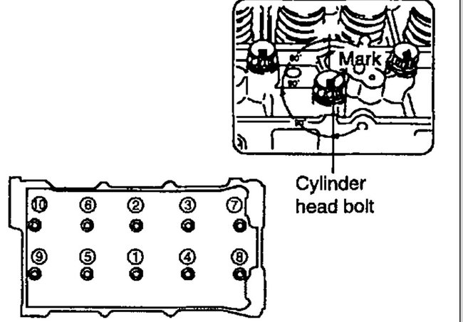

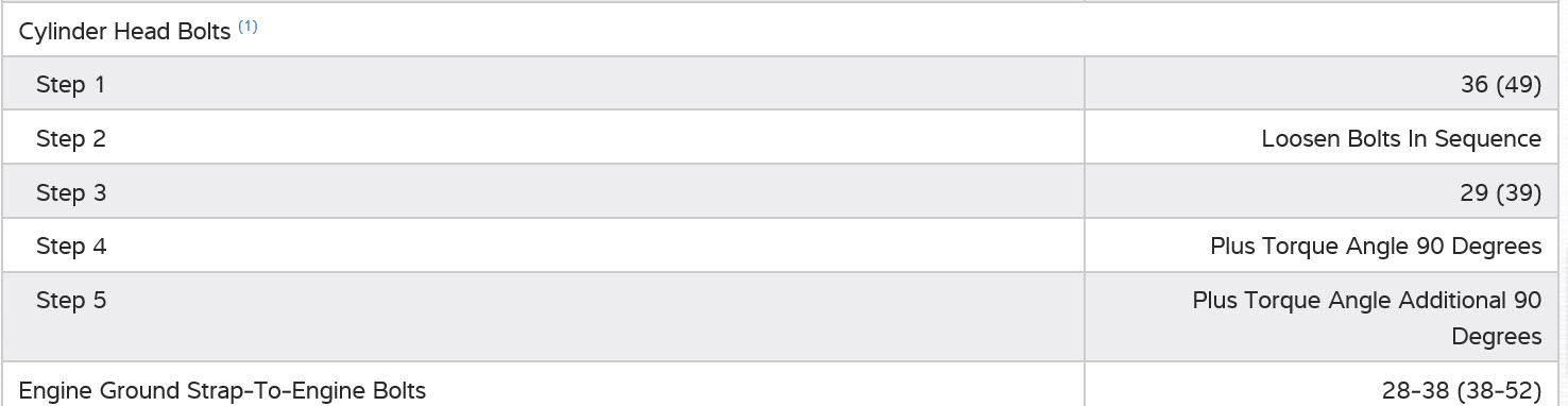

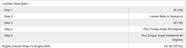

I need the torque specifications for a 02 KIA spectra after replacing the head gasket
Jan 21, 2016 at 11:25 PM
HMAC300
Experienced Mechanic
48,601 POSTS
see pictures below for a 1.8L engine.
