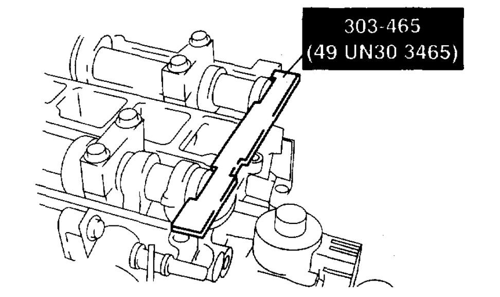

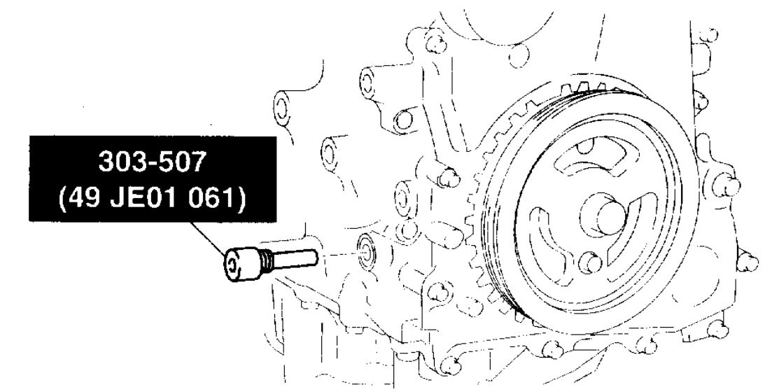

Another question is, how do you set timing, it uses chain + twin cams?
Aug 14, 2019 at 5:05 AM
Do you mean setting the timing chains?
Aug 14, 2019 at 6:46 AM
TOFFEE
  • 9 POSTS
Yes.
Aug 14, 2019 at 6:51 AM
Okay, you need 2 special tools for this.
One is to lock the engine at top dead center and the other is to lock the cams at the same.
