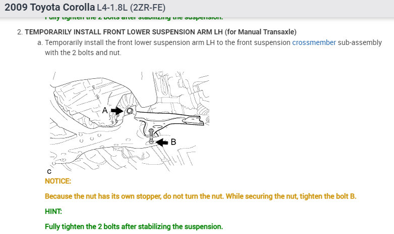

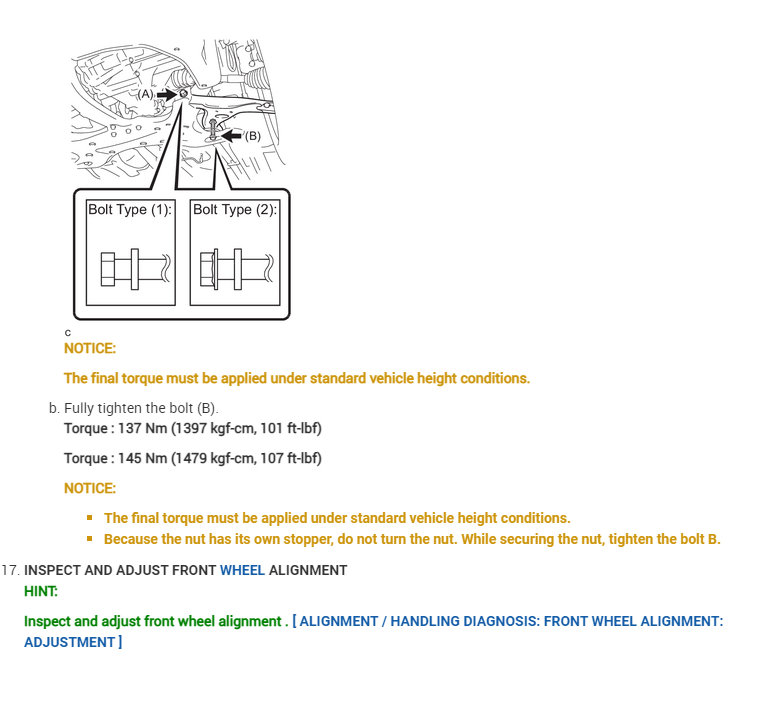

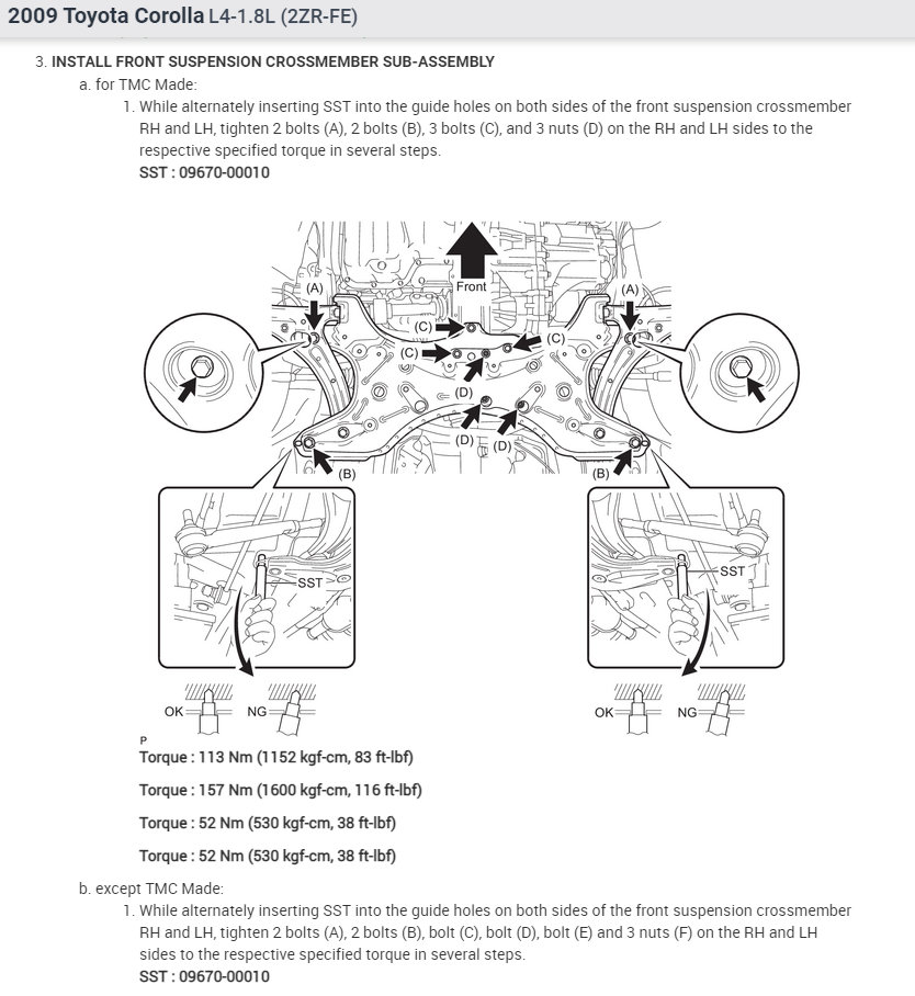

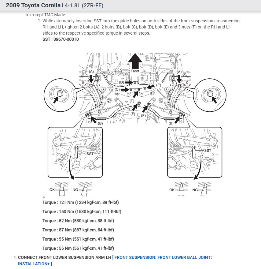

How tight should I tighten the lower control arm bolts?
Jan 6, 2022 at 1:46 PM
SQM
  • 6,383 POSTS

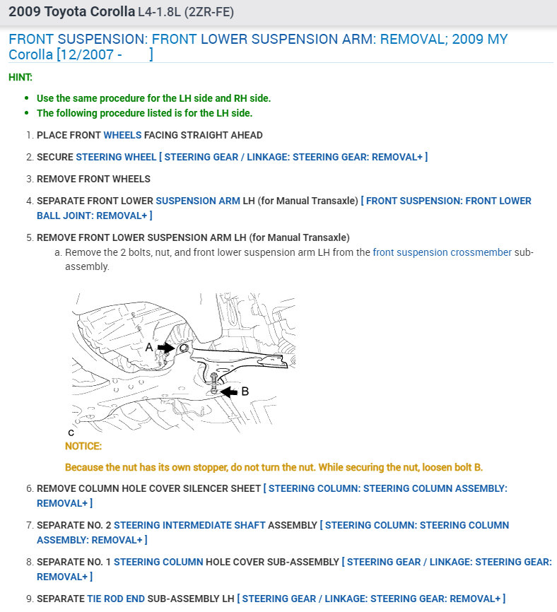

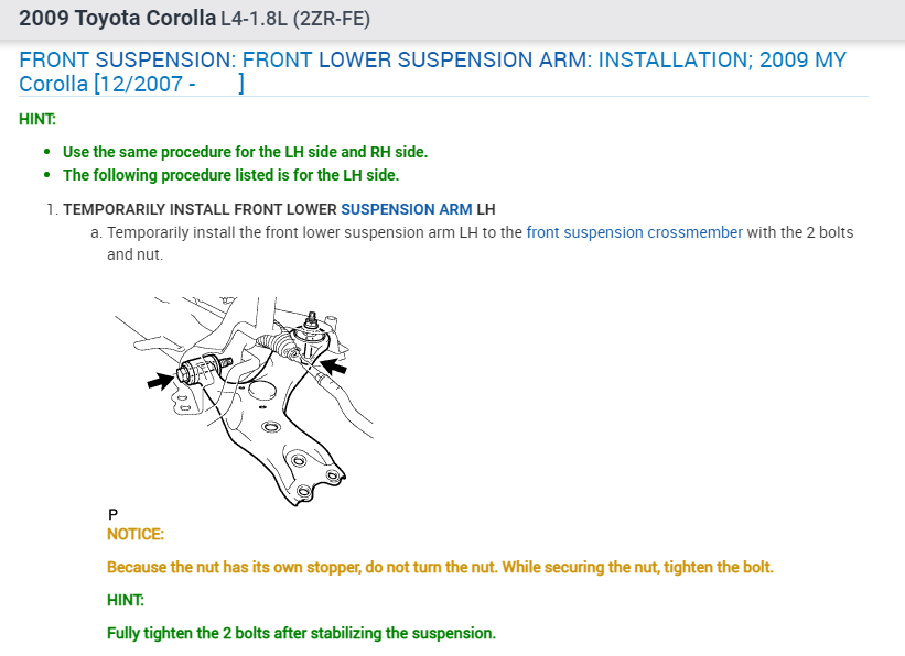

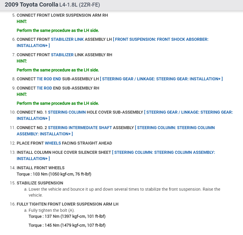

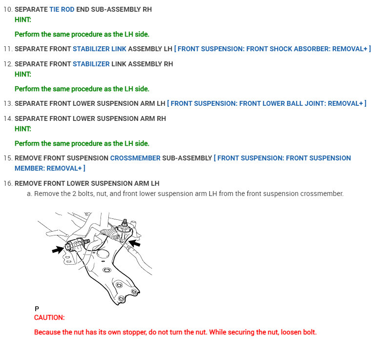

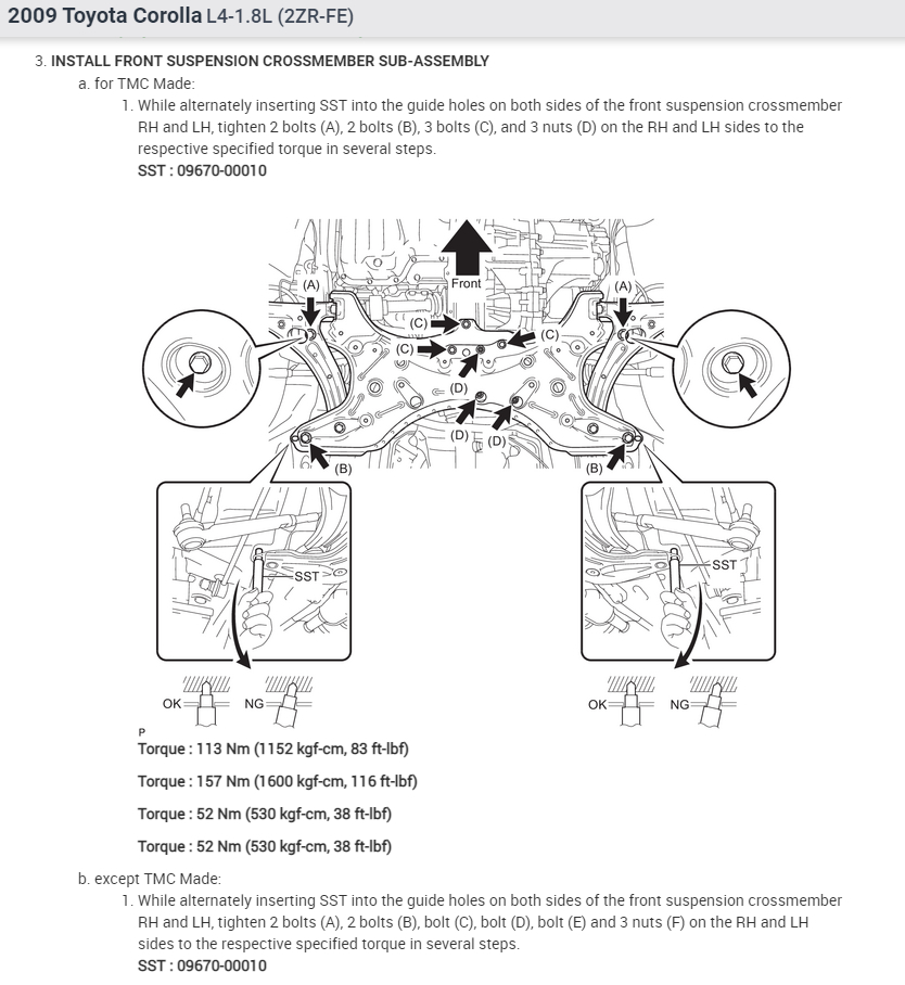

There are a couple of different variances for the torque for the control arm bolts. It will depend on the style that you have.
I have attached the replacement procedure including all the bolts torque specifications below.
https://www.2carpros.com/articles/lower-control-arm-bushing-replacement
