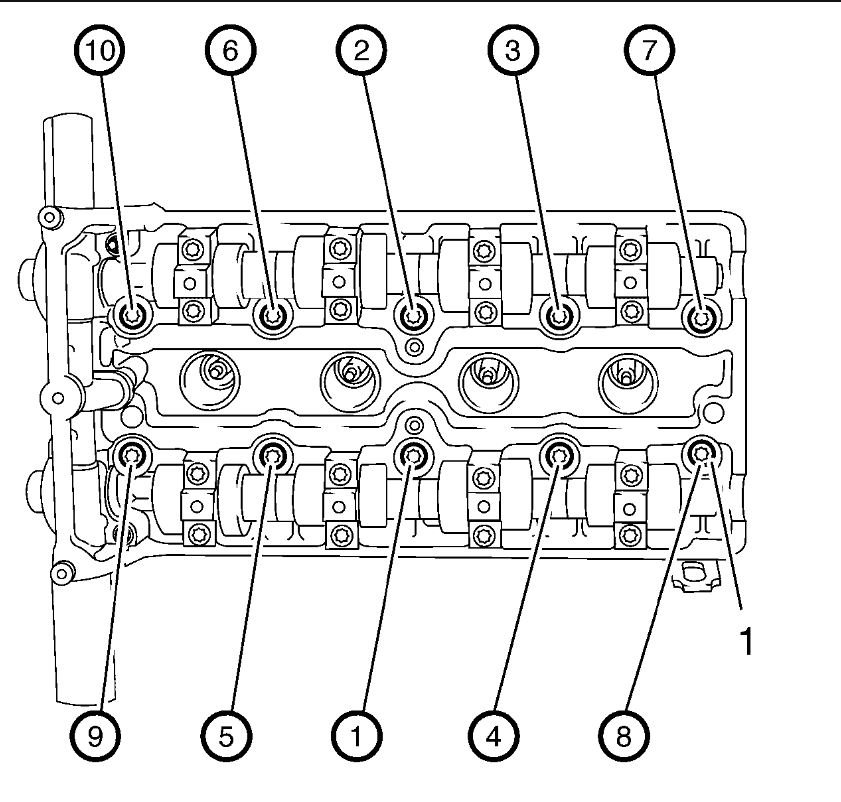

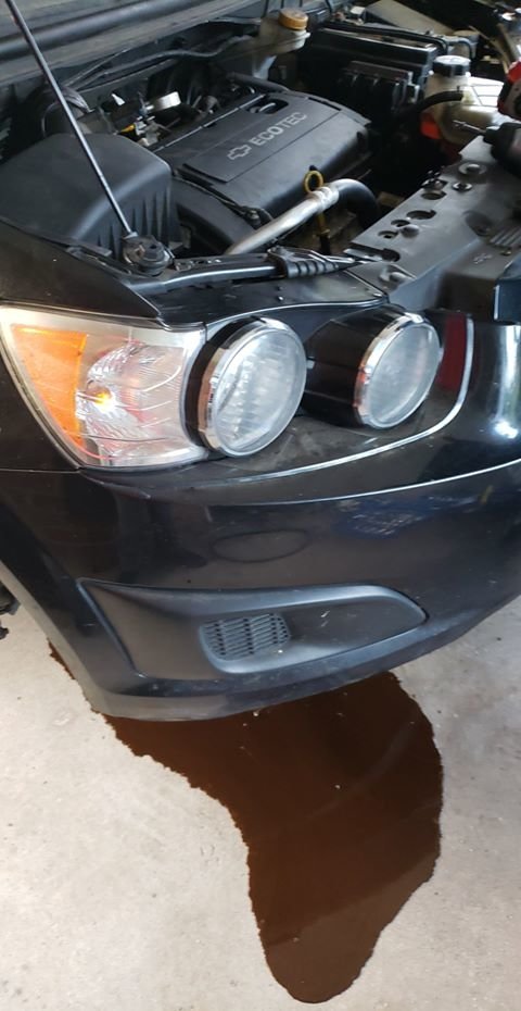

I'm new to this and was following the instructions on csman.com for my head gasket replacement. I followed the instructions to a T. I tighten my head bolts as per the instructions provided below. Now I understand that the first pass is at 18 lb ft torque. I just don't understand if the 2nd-5th are ft lbs or degrees? Because that's where my confusion starts. This is what happen because I thought it was 18 ft lbs for each pass.
Tighten the bolts (1) in 5 passes. Use the EN-45059 sensor kit :
First pass to 25 N.M (18 lb ft).
Second pass to 90 .
Third pass to 90 .
Fourth pass to 90 .
Final pass to 45 .

The 2nd-5th passes are degrees. These are torque to yield bolts and must be replaced anytime they are taken out. So go to 18ft lbs then use a torque angle gauge to do the remaining passes as follows
* First pass to 25 Nm (18 lb ft).
* Second pass to 90°.
* Third pass to 90°.
* Fourth pass to 90°.
* Final pass to 45°.
