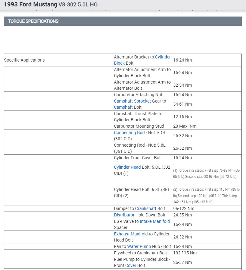

Hello, my name is Jr. I am currently building my 302-engine going mostly stock, trick and flow pistons, b303 cam, Edlebrock lower and upper manifold. I was wondering if you guys have a book or a website with a complete torque specs to tight down all my bolts to specs.

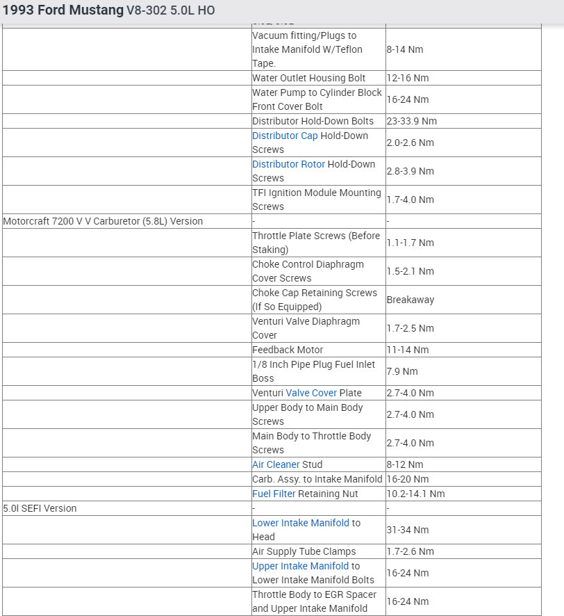

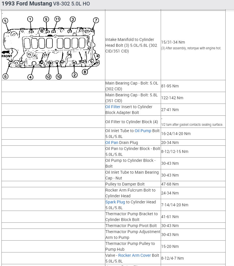

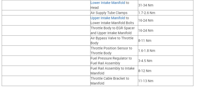

Please see attached for the factory torque specifications chart for the 5.0L engine.
Let me know of any questions.
