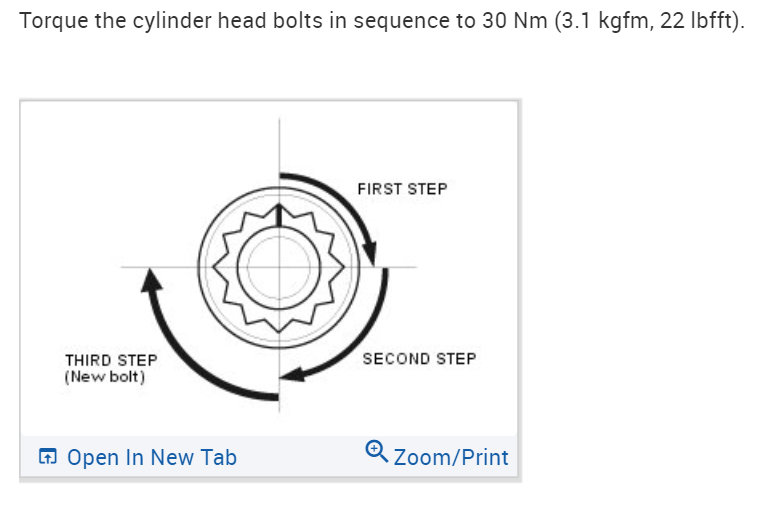

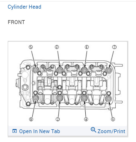

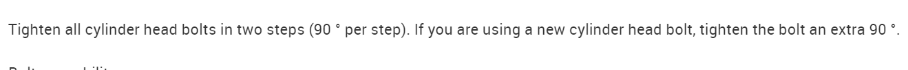

Please, could you help with torque specification for front Cylinder Head?
2013 ACURA RDX
120,000 MILES • 3.5L • 6 CYL • 2WD • AUTOMATIC
JAYNAIDU13
torque specification needed for the vehicle listed above.
Thank you so much.
Aug 20, 2022 at 2:21 PM
  • 110,241 POSTS
I would be happy to. However, there is a process to torquing the head. If you look below, I included the procedures and specifications.
If you need additional information, let me know.
Take care and let me know if this helps.
