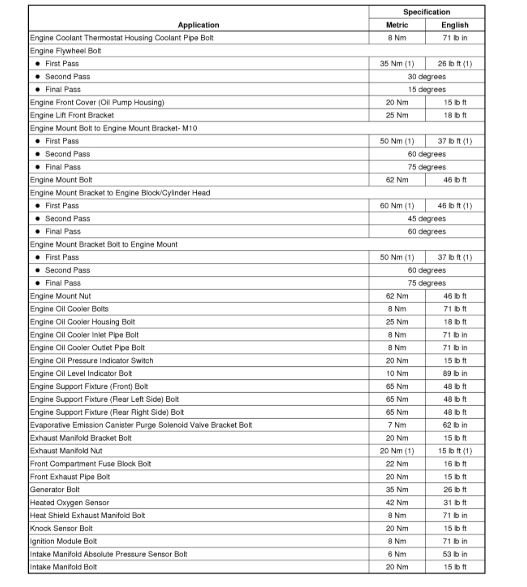

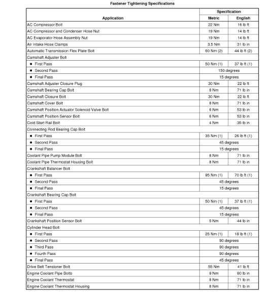

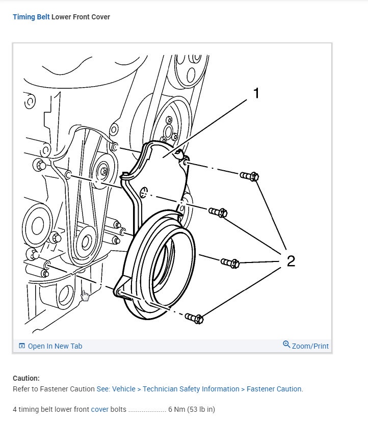

I’m replacing the timing belt and thermostat and would like to know if someone has the torque specs for all the bolts.
Mar 9, 2020 at 6:51 AM
Experienced Mechanic
52,796 POSTS
Good afternoon,
I attached all the torque specs for the motor for you.

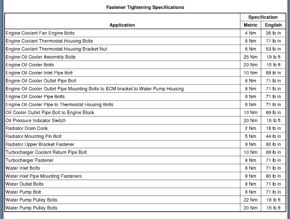

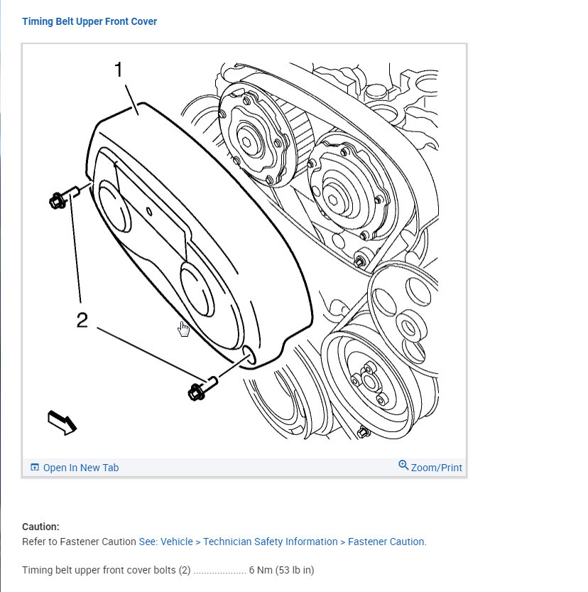

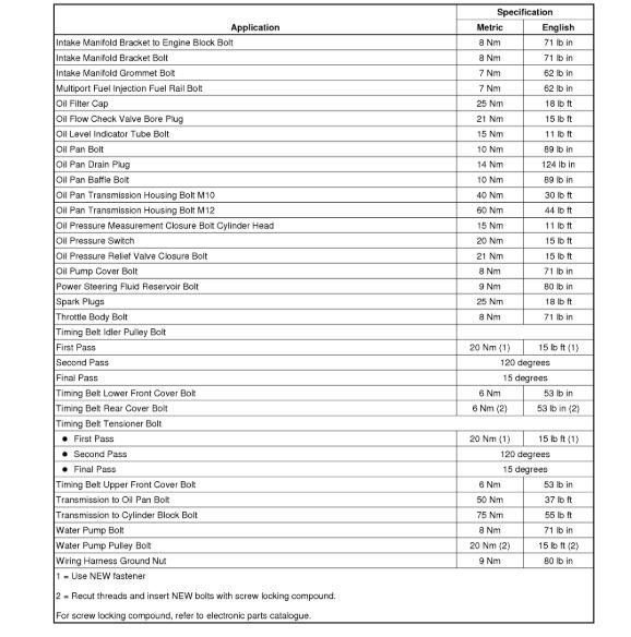

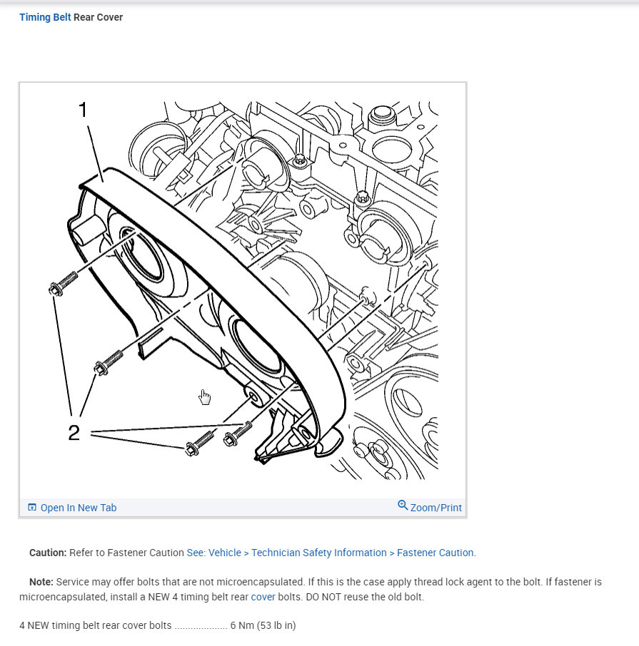

18,907 POSTS
I think I got all the specs for you. Let me know if you need more and I will get them.. Thanks.

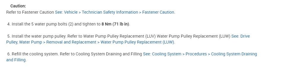

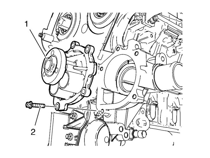

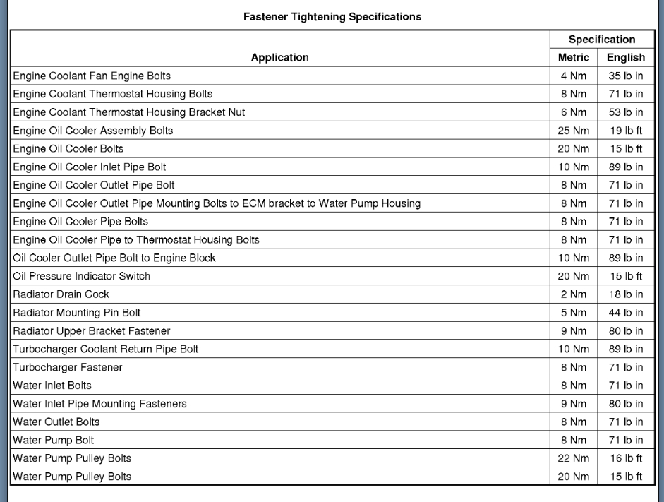

Thanks again gents, do y'all have the diagrams for the water pump as well? Might as well replace that while I'm in there. :)
Mar 11, 2020 at 11:27 PM
52,796 POSTS
Okay, I attached a picture of the pump for as well as the spec for the bolts.
