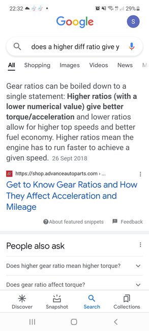

Thanks again Boris. So, if I have the 5-speed gearbox and I switched the differential to a 3.46 differential from a factory 6speed manual xr8 I'd get a little more torque than my 3.46 differential and 5-speed box factory setup? Will I also need to get my speedometer recalibrated too?

Swapping to the 3.46:1 rear end would give you longer legs so would reduce the low-down grunt.
I believe your best bet would be fitting the 6-speed gearbox. The gears are closer together and better matched.

Now I'm confused Boris. Are you sure that's the correct information you have given me?
Feb 23, 2022 at 8:33 PM
Sorry for the delay. I think what Boris was saying is the 5 speed with the lower (higher number value) gear and 6 with the higher gear are matched pretty closely so you are not going to get much difference in performance.
However, if you have a 6 speed with the higher gear (lower number) and swap lower gear then you are going to have more low-end torque and the RPM is going to be significantly higher in each of your 6 gears.
So, this will give better performance and throttle response but will hurt your fuel mileage as the RPM will be higher.
