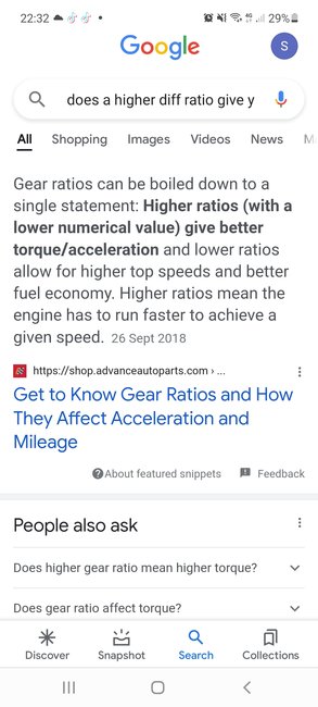

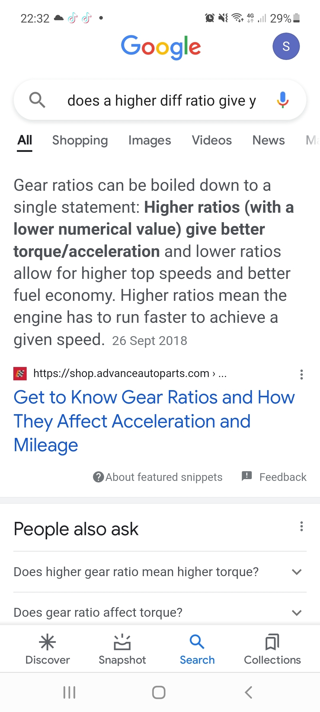

SKV7STEVEN
  • 5 POSTS
Now I'm confused Boris. Are you sure that's the correct information you have given me?
Feb 23, 2022 at 8:33 PM
Sorry for the delay. I think what Boris was saying is the 5 speed with the lower (higher number value) gear and 6 with the higher gear are matched pretty closely so you are not going to get much difference in performance.
However, if you have a 6 speed with the higher gear (lower number) and swap lower gear then you are going to have more low-end torque and the RPM is going to be significantly higher in each of your 6 gears.
So, this will give better performance and throttle response but will hurt your fuel mileage as the RPM will be higher.
Hope this helps.
Feb 26, 2022 at 10:02 PM
