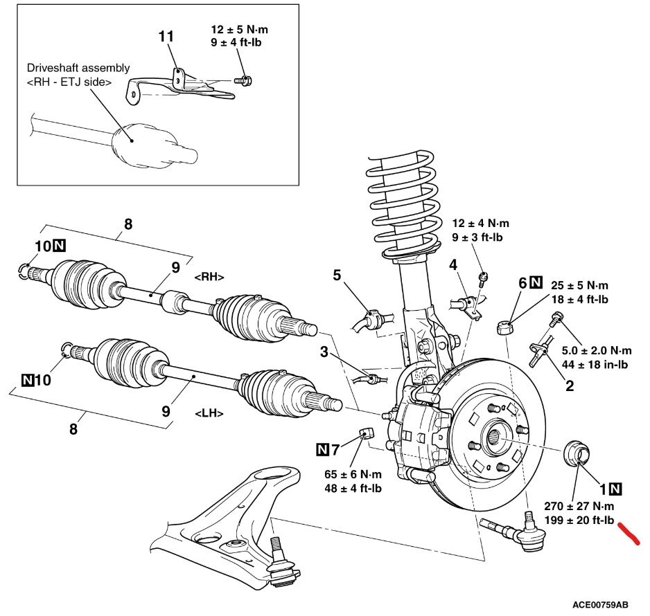

What is the torque spec on a front axle nut for a 2015 Mitsubishi Mirage? I’ve seen sites say 200 ft/lbs and others say 129 ft/lbs.

These are the service info specs. The 200 pounds was closest. 199 +- 20
Image (Click to enlarge)
