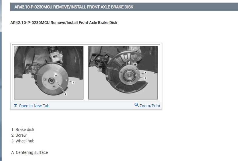

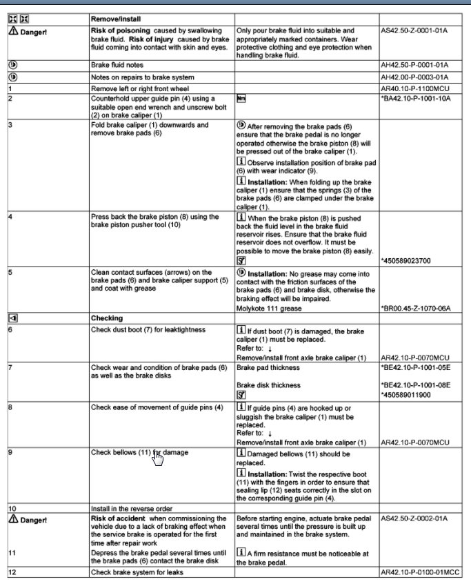

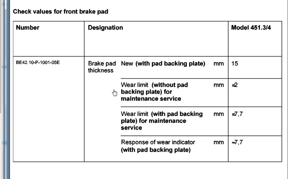

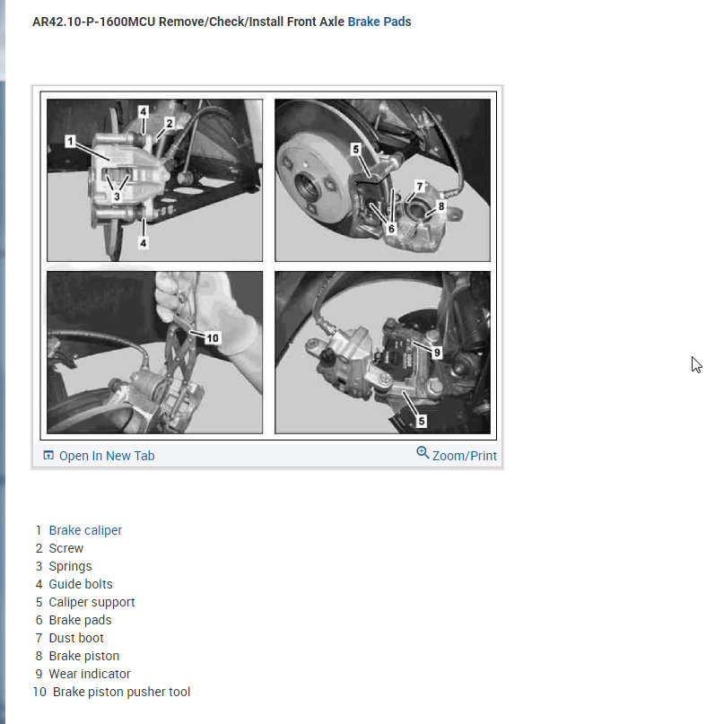

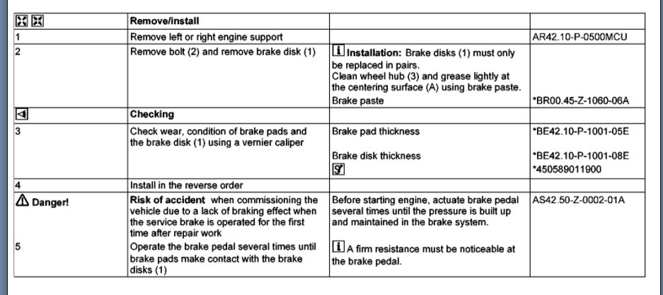

Can someone explain this repair please?
Mar 30, 2018 at 2:35 AM
Experienced Mechanic
18,907 POSTS
Below are some guides that will walk you through this complete repair. Please run though this material and let us know if you have questions.
https://www.2carpros.com/articles/how-to-replace-rear-brake-pads-and-rotors
https://www.2carpros.com/articles/how-to-bleed-or-flush-a-car-brake-system
Attached below you will find the process from the manual for additional information. Please let us know if you need more info. Thanks
