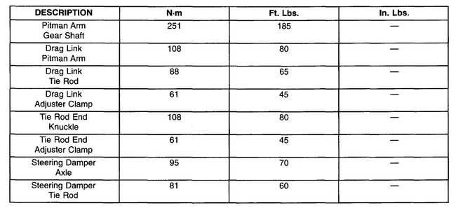

I am replacing the tire rods on my truck listed above 1500 four-wheel-drive, and I need the torque specs for the tie rods (all the rods related up front).
Thank you

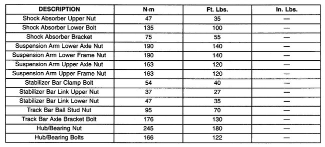

Here's what I found for the steering system in the first image, and the front suspension in the second image. There are some other minor listings. Let me know if there's anything else you need that isn't here.
