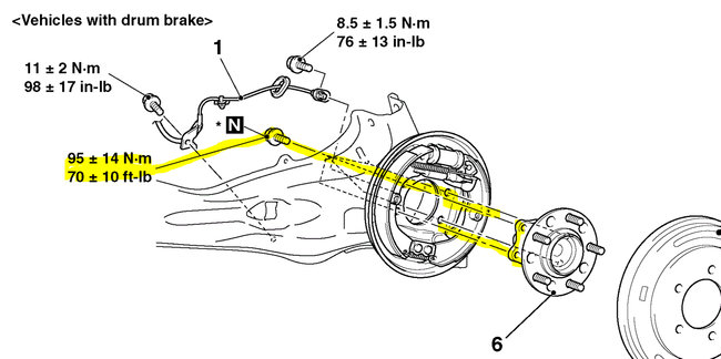

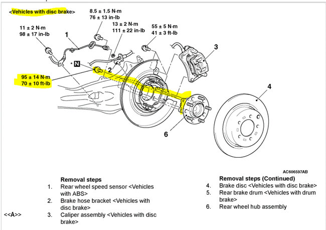

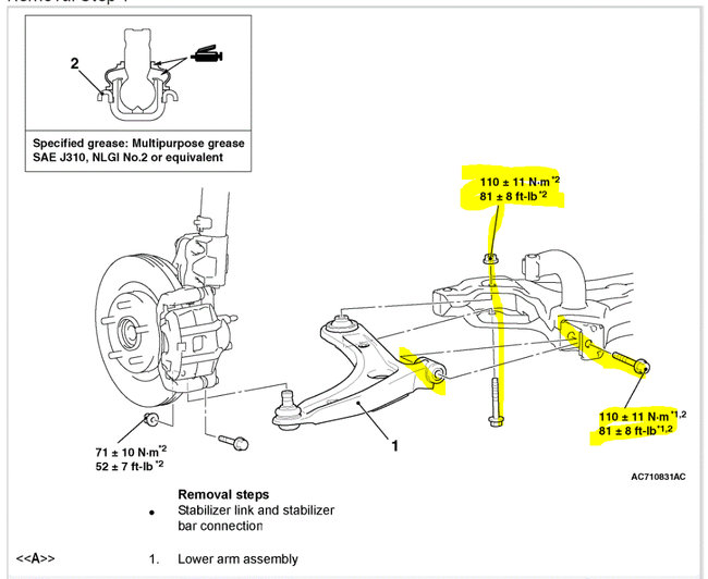

I need the torque spec for the two bolts that hold the lower control arm. I also need the torque spec for the rear hub assembly bolts.

It sounds like you've been busy. LOL, the control arms are always difficult due to corrosion. At least it is that way where I am located.
Regardless, I attached two pics below. One is an exploded view of the front lower control arm and the second and third are exploded views of the rear hub assembly. Note, one indicates disc brakes, and the other indicates drum brakes. The torque appears to be the same, but I added both.
Let me know if this is what you need or if you have other questions.
