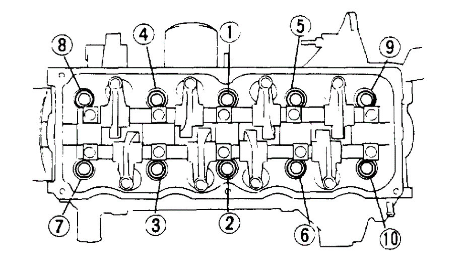

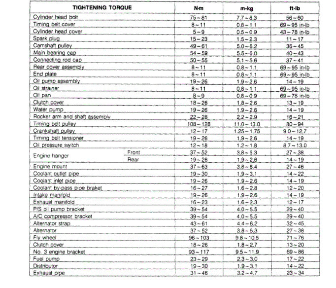

I need to know torque sitting of cylinder head specs and big end specs.
Aug 29, 2020 at 4:23 PM
Good morning,
I attached the toque and sequence for you for tightening the head bolts.
Aug 29, 2020 at 8:53 PM

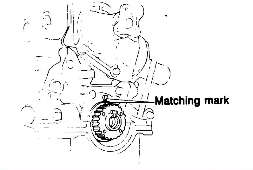

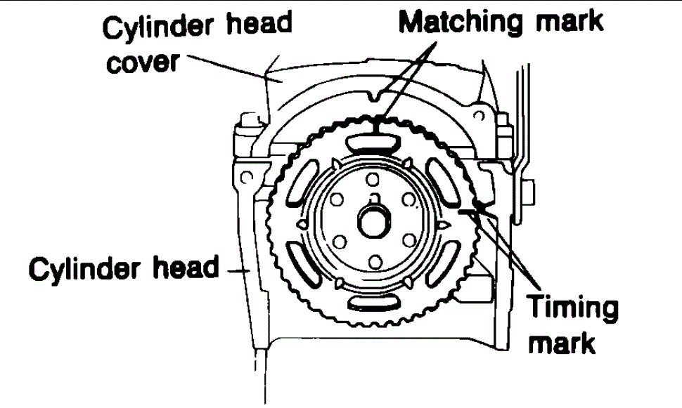

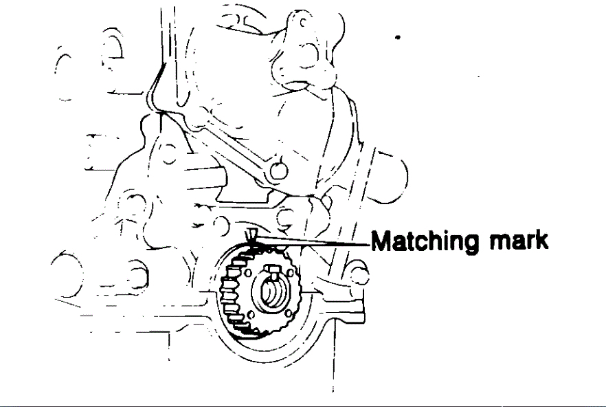

Thank you for your answer. Now i need to know the timing marks on crankshaft and camshaft. does timing chain have marks? E 3 engine.
Aug 30, 2020 at 9:41 AM
Okay.
Aug 30, 2020 at 8:29 PM
KNOWLEDGE GWAMURE
  • 11 POSTS

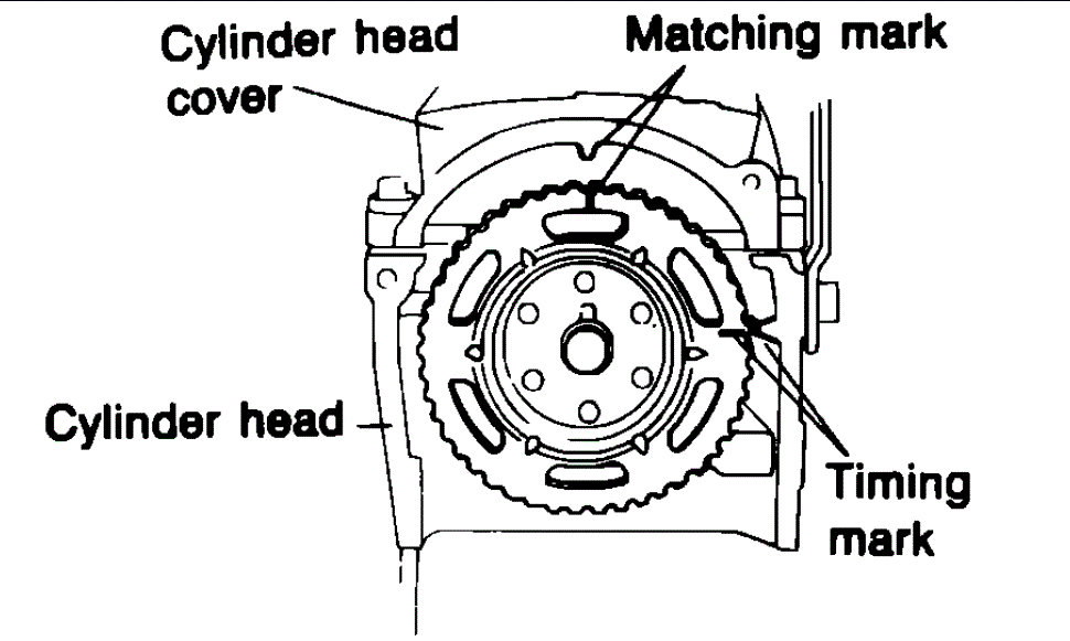

Images you send is for belt driven mine is a chain driven with 1 mark on the camshaft pulley.On crankshaft cover written for TDC and 10 degrees.

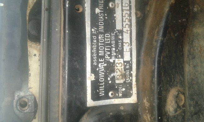

Can I have the complete VIN number for the car?
Aug 30, 2020 at 11:34 PM
KNOWLEDGE GWAMURE
  • 11 POSTS
I replace the window screen i think they cover that number, but let me send the data card.
Aug 31, 2020 at 4:37 PM
I am sorry, that is not the VIN number.
Look on the drivers door for the number.
Aug 31, 2020 at 9:11 PM

Okay, I just checked with the Mazda web site and the marks are the same as what I sent you.
The difference was your used a chain and the one I sent you used a belt.
Sep 1, 2020 at 9:35 AM
