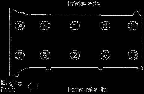

torque settings for the cylinder head, main bearings and big end bearings?
2008 DAIHATSU TERIOS
65,000 MILES • 1.5L • 4 CYL • 4WD • MANUAL
JANV699
Hi, I need the torque settings for the cylinder head, main bearings and big end bearings as well as the torque sequence for the vehicle listed above it is the J200 model.
Dec 11, 2017 at 10:07 PM
KHLOW2008
  • 41,814 POSTS
Hello this should help,
Cylinder head tightening torque 34 N.m + 90 degrees, Main bearing tightening torque = 53 - 65 N.m, Con-rod bearing torque = 19.5 - 24.5 N.m
Check out the diagrams (Below). Please let us know if you need anything else to get the problem fixed...................
