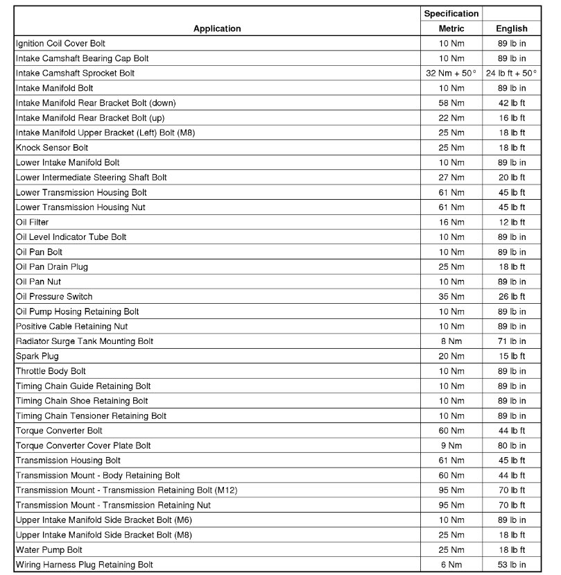

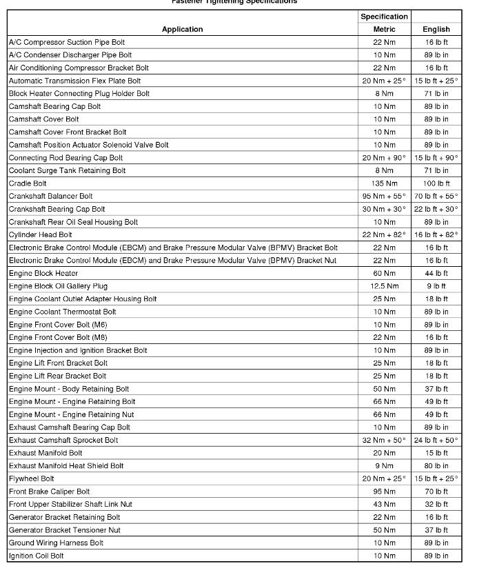

Please assist with all Engine torque settings for the vehicle listed above b10s.
May 10, 2023 at 3:59 AM
Experienced Mechanic
55,732 POSTS
Sure, here are the engine torque specifications in the images below. Please let us know if you need anything else to get the problem fixed.
