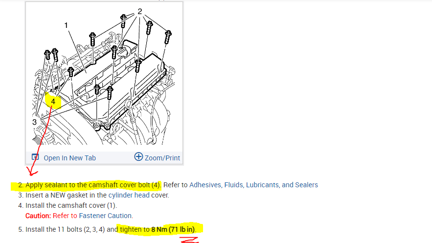

Replacing the rocker cover gasket and reinstalling rocker cover, I need the correct torque settings and sequence for bolts.
Jun 28, 2024 at 6:10 AM
  • 110,244 POSTS

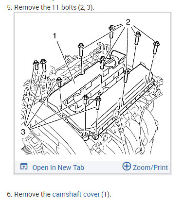

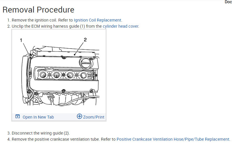

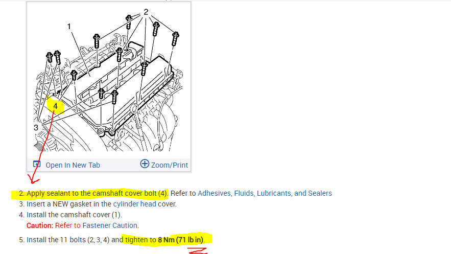

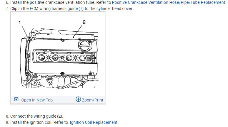

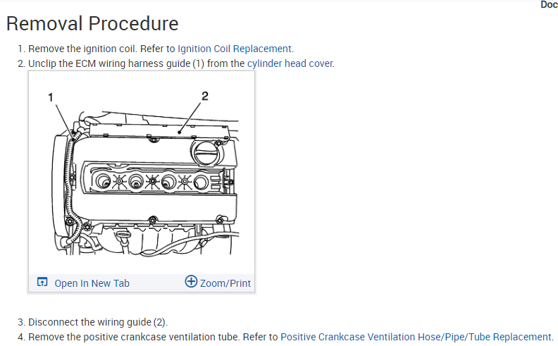

If you look below, I attached the directions for the removal and installation of the cylinder head cover. Note there is one bolt toward the front of the engine, you must use sealant on the threads, or it will leak.
The torque specifications are 71-inch pounds. (not foot pounds)
Let me know if this helps.
