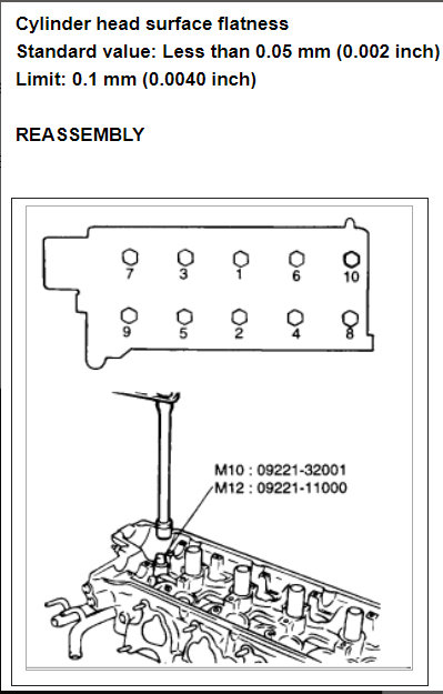

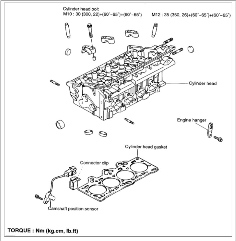

Hi, I need torque setting for the head.

I am attaching the torque specs for a 1998- 2004 4 cylinder engine. We do not have specs for a 2009 but it appears the engine is same so the torque specs are going to be the same. Take a look at the spec below and let us know if there are other questions. Thanks
