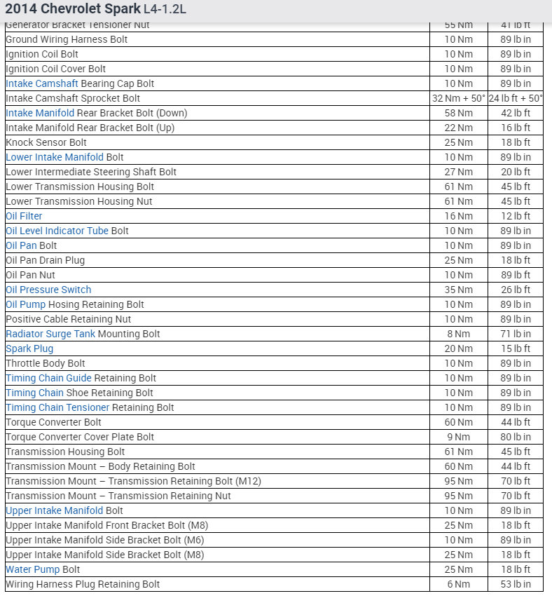

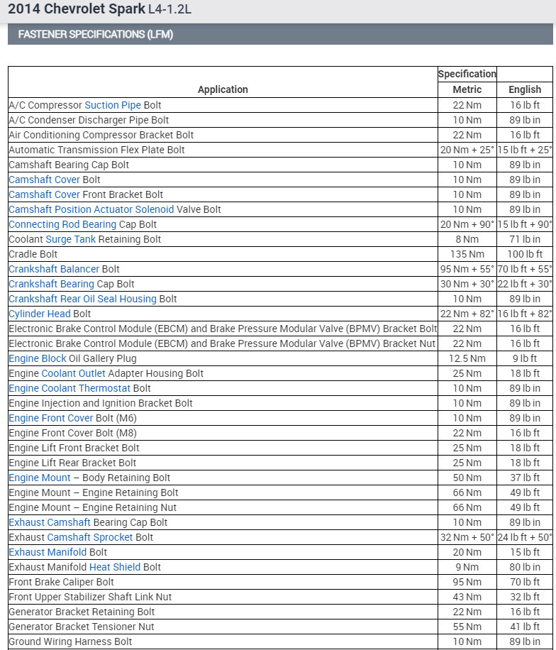

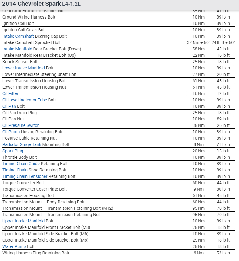

I need the torque settings for my engine.

See attached for the torque specifications.
